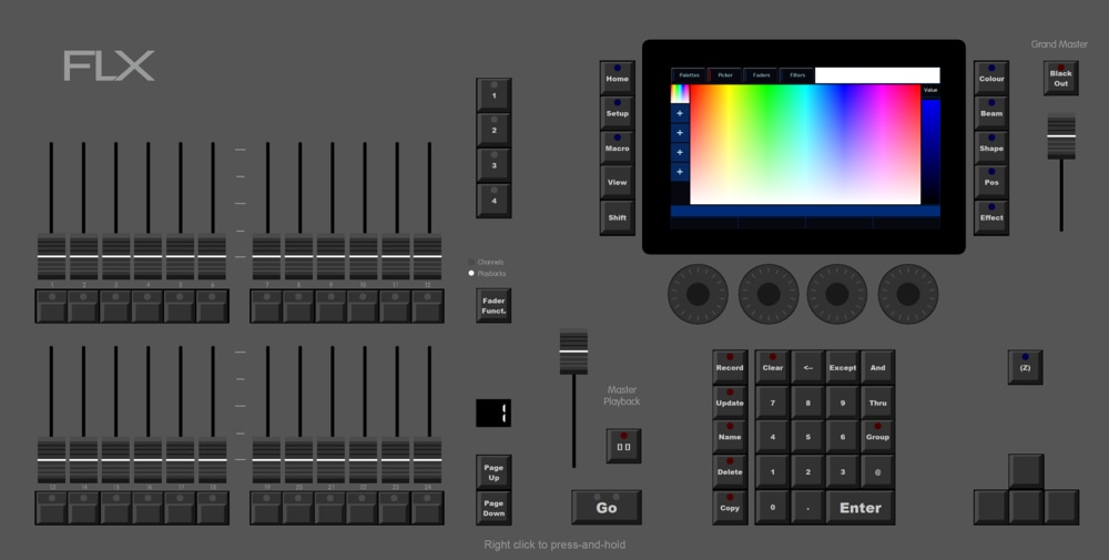

Edward Z88 Posted November 17, 2021 Report Posted November 17, 2021 As an update to this thread, the Phantom ZerOS Front Panel windows of FLX series consoles have had a large update... 1 Quote Edward Smith Formerly: Zero 88 Product Specialist - Email Support Currently: Obsidian Control Systems Product Specialist
HenryYandell Posted November 27, 2021 Report Posted November 27, 2021 On 11/17/2021 at 3:44 PM, Edward Z88 said: As an update to this thread, the Phantom ZerOS Front Panel windows of FLX series consoles have had a large update... Are there any plans for something like this for the solution/leapfrog series? Quote
Edward Z88 Posted November 27, 2021 Report Posted November 27, 2021 Hi @HenryYandell Welcome to the Zero 88 Forum. 6 hours ago, HenryYandell said: Are there any plans for something like this for the solution/leapfrog series? There are currently no plans to bring this to Solution/Leapfrog consoles. Leapfrog and Solution consoles are combined on Phantom ZerOS, and so have the black background of the Solution consoles. Edward Quote Edward Smith Formerly: Zero 88 Product Specialist - Email Support Currently: Obsidian Control Systems Product Specialist
HenryYandell Posted November 28, 2021 Report Posted November 28, 2021 14 hours ago, Edward Z88 said: and so have the black background of the Solution consoles. Hi Edward, I understand that they look like the latest refresh of the boards since we use a solution ourselves, however for someone who doesn’t know the board inside out not having button labels does somewhat complicate things a little. (Also please let me know if that’s an issue with me installation if I’m wrong 😅) Many thanks, Henry Quote
Edward Z88 Posted November 29, 2021 Report Posted November 29, 2021 Hi Henry, On 11/28/2021 at 8:35 AM, HenryYandell said: for someone who doesn’t know the board inside out not having button labels does somewhat complicate things a little. If you hover your cursor over a button, the button's function will be displayed at the top of the Front Panel window in the title bar. You will also be able to use some keyboard shortcuts to control Phantom ZerOS as well. Please see the link below for more information... https://zero88.com/manuals/zeros/shortcuts/keyboard-shortcuts#flxs Hope this helps, Edward 1 Quote Edward Smith Formerly: Zero 88 Product Specialist - Email Support Currently: Obsidian Control Systems Product Specialist
HenryYandell Posted November 29, 2021 Report Posted November 29, 2021 5 hours ago, Edward Z88 said: Hi Henry, If you hover your cursor over a button, the button's function will be displayed at the top of the Front Panel window in the title bar. You will also be able to use some keyboard shortcuts to control Phantom ZerOS as well. Please see the link below for more information... https://zero88.com/manuals/zeros/shortcuts/keyboard-shortcuts#flxs Hope this helps, Edward That’s perfect! Should’ve see that really in hindsight, thanks for the help Edward 1 Quote
