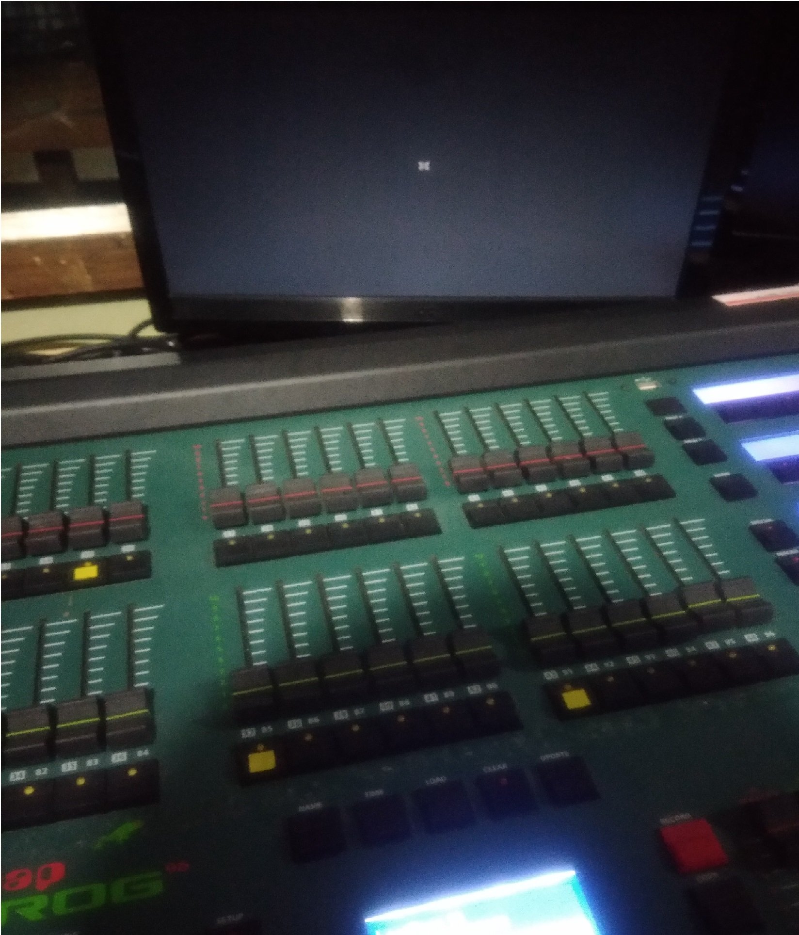

dg_marvz@yahoo.com Posted July 5, 2018 Author Report Posted July 5, 2018 hi, thanks for the quick response Ian and Edward.. i have a bigger problem now Just recently today the console did not boot. After Complete loading, the monitor just went black with an X in the center and the tiny monitor in the console is displaying "loading please wait" . hope you can help me with this problem. Btw i did not update the console yet.. Quote
iank99 Posted July 6, 2018 Report Posted July 6, 2018 (edited) The 'X' is the cursor generated by the X-windows subsystem in ZerOS as the operating system initialises. Did you notice before the desk got to this stage whether lots of text scrolled up the screen before it blanked and the 'X' appears? If you did, then the processor is probably running ok but it encountered an issue as it tried to initialise the graphics. If you feel confident opening the desk - I'd swap the internal battery (if you've never changed it - can never hurt doing, it's a CR2032) and whilst you're inside ensure that the flash disk is secure. The flash disk is a square device plugged on to the mainboard that holds the OS - sometimes they can work loose and just need reseating - a gentle push with your thumb is enough. The desk might reboot ok then - I've rarely found anything that stops these desks booting unless they've been really abused. It would also be worth unplugging anything plugged in to the USB ports on the desk such as keyboards, mice, phone chargers, lights or fans. The USB hub inside the desk doesn't provide a lot of current on the USB ports so anything that draws a lot of current like older USB items can cause boot issues - I think they're initialised as the X windows subsystem is "booted" hence your desk crashing. You shouldn't be plugging much USB in to the desk except newer keyboards, corded mice and flash sticks - if you need USB lights, fans, rocket launchers, mug warmers or what have you - then a powered USB hub is the way to run those. I would offer to come and look but I just noticed you're in the Phillipines - so that may be costly - might be time to research local Zero88 repair centres just in case Edited July 6, 2018 by iank99 To add a comment about call out. Quote Ian Knight aka The Service Guy - www.serviceguy.co.uk

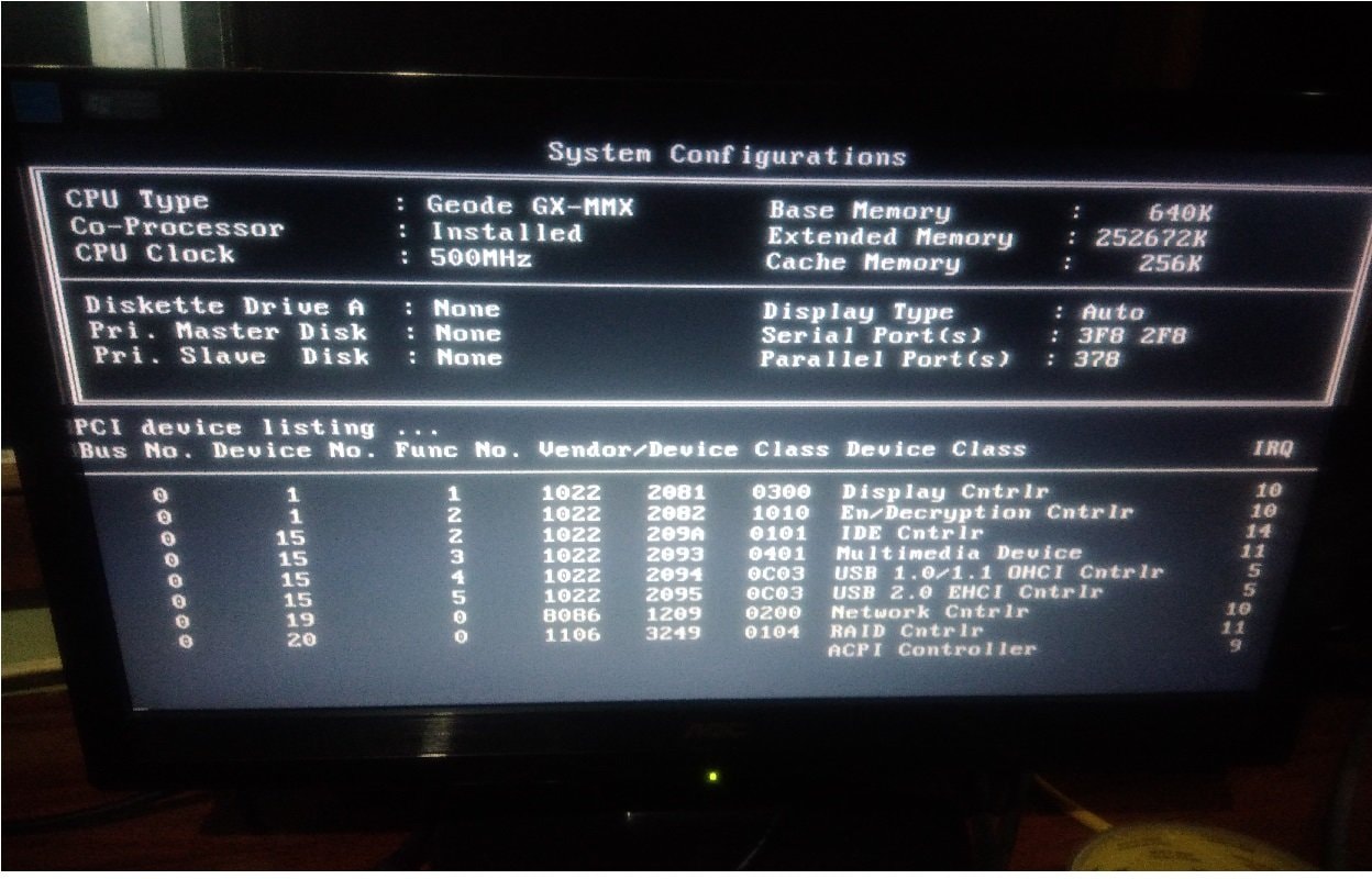

dg_marvz@yahoo.com Posted July 7, 2018 Author Report Posted July 7, 2018 I change the battery, push the flash disk but same result. i also did try to boot USB-ZIPP and the picture below appears then Z logo will appear then goes blank. So sorry im just a newbie in this. i don't want to try anything without consulting coz i may damage it further... Quote
Edward Z88 Posted July 7, 2018 Report Posted July 7, 2018 Hello, Please try re-installing ZerOS 7.9.4. You can do that by downloading and then extracting the software from our website... Then run the ZerOS 7.9.4 OS Creator USB software on preferably a Windows 7 PC, which will then prompt you to format a USB stick. Complete the Wizard, and then plug the USB port into the console and boot. If this doesn’t work, please email Keith as Ian suggested, or email support@zero88.com. Depending on the situation, the console may need to be sent for repair. Any queries let me know. Edward Quote Edward Smith Formerly: Zero 88 Product Specialist - Email Support Currently: Obsidian Control Systems Product Specialist
