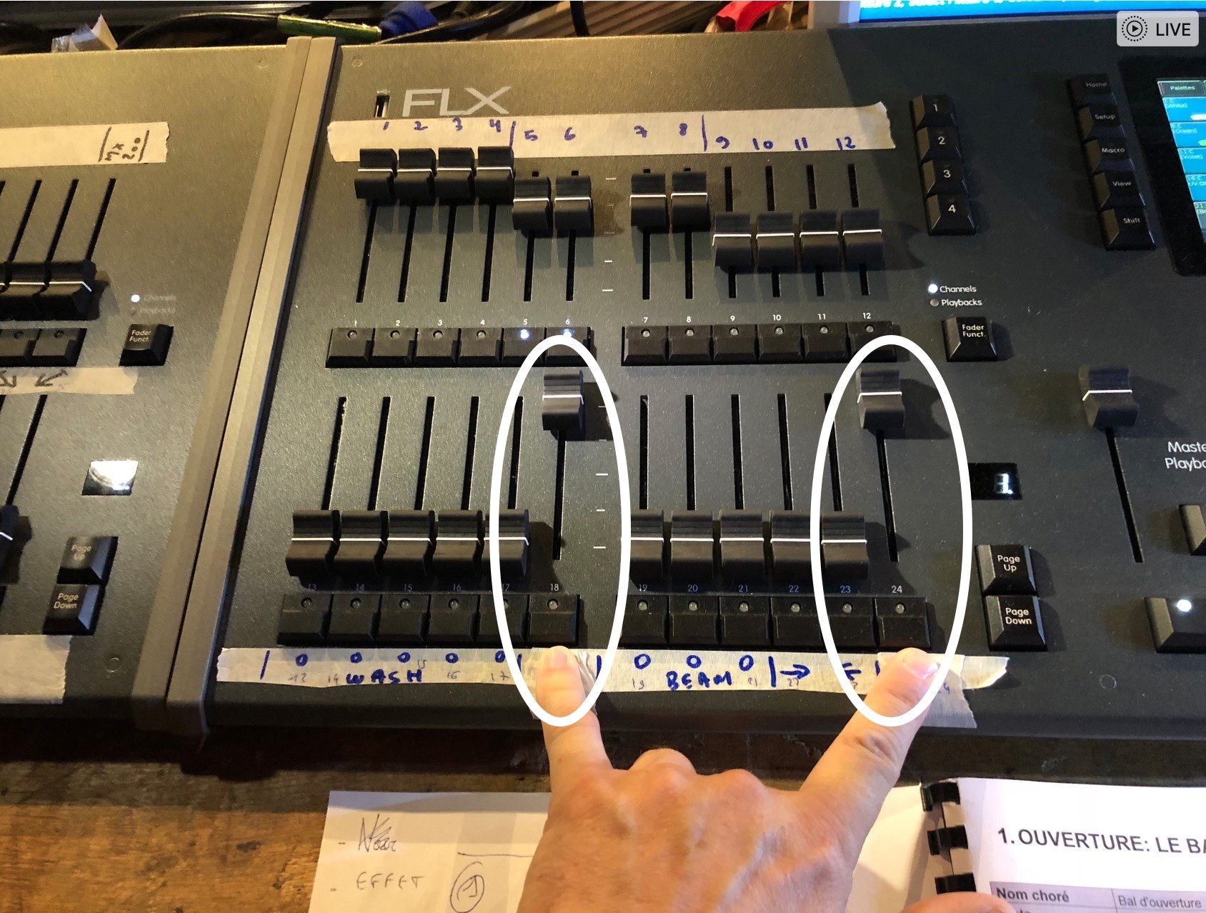

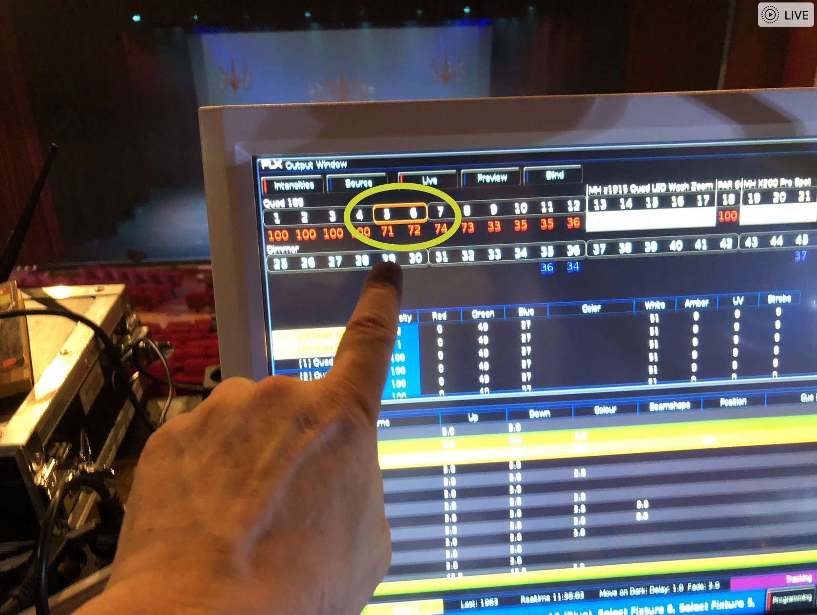

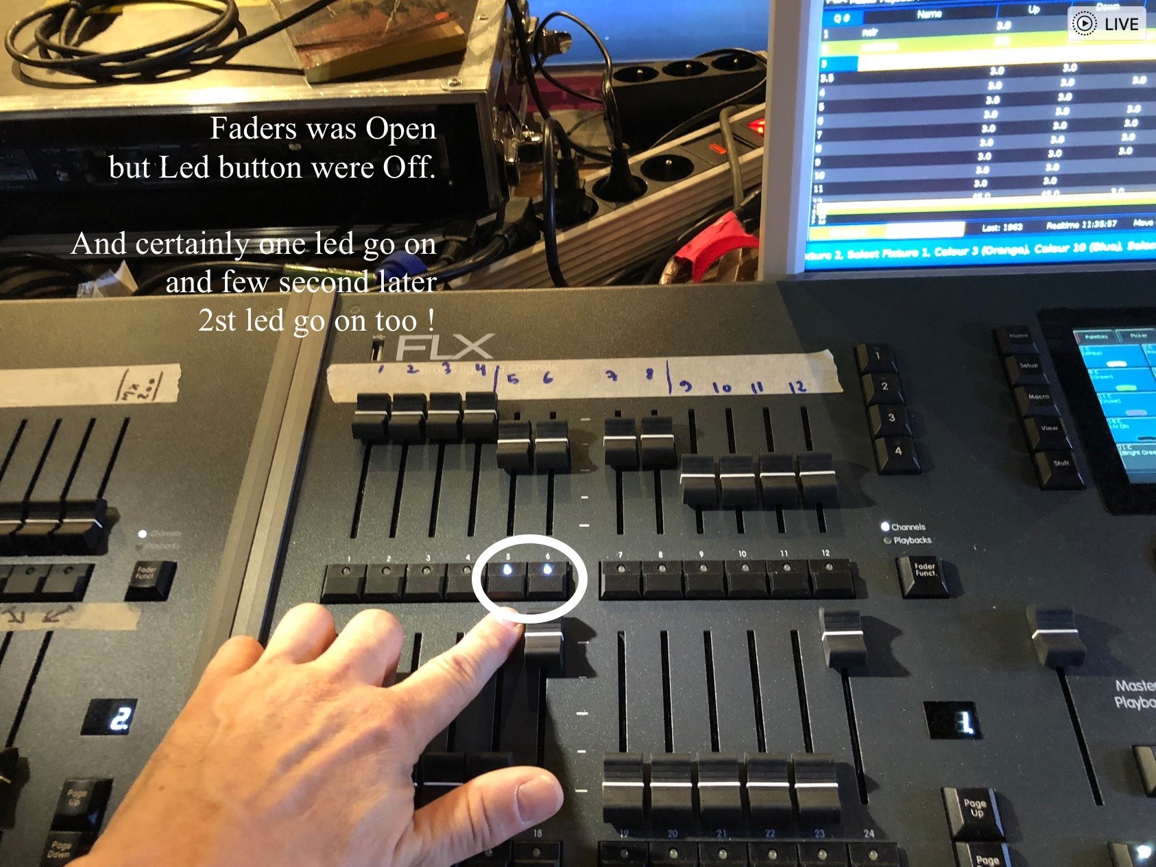

ole
still a problem during my encoding this Sunday.
I was working on two faders and suddenly without touching anything a led that turns on another fader and 30 seconds later a second LED that turns on ... And we see on the screen that the selection is active ...
My ghosts are still here ...

Hi Eric,
I understand your problem now. This is due to the sensitivity of “Auto Select Channel on Fader Movement”. This is to be revised in the next software update, to stop this happening. In the meantime if this is causing you problems, you can turn it off by tapping SETUP -> System Settings, and Disable the option.
Any queries let me know.
Edward

Hello,
Thanks for your help. I will do it.
Then the only trouble to do this is that to gain access to a projector, it will be necessary to alleviate the button (activation of the LED) then open the fader. This is two actions instead of one ... A bit of time wasting on a long encoding ...
So if I understand correctly it is a great sensitivity of the Faders that makes that from time to time put the LED function of the MMF fader ?
By cons what I do not understand is that during my first show, I had indeed the LED of a MMF button that was lit, but without I move the Fader, the intensity was mounted all alone at 30/35% (Fader was on Zero). And so I had to mount the Fader to reach the value of the intensity and to lower it to zero to turn off the projector on stage ...
In fact it looks as if there was an invisilble order to turn on the LED + the projector on stage during the performance ...

Hi Eric,
That is correct, we are going to adjust the auto select sensitivity. The buttons are used to select the fixture, so that you can control it further. Therefore if you wish to turn this setting off, all you’ll have to do is manually select the fixture you wish to control further- you don’t need to press the button before moving the fader.
If fixtures seemed to be randomly turning on, can you remember what colour the fixtures intensity was displayed as in the Output Window? This will help to determine why that might be happening- such as an auto cue for example.
Edward
