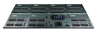

van den abbeele Eric Posted June 5, 2018 Author Report Posted June 5, 2018 Hello, I come back on this thread, having no answers about my worries ... Last Saturday at the first show with the FLX, at a time, without me touching anything, a led of a channel turned on by itself and that to turn on the floodlights of the channel. This happened twice ... Kevin told me that this may be due to the trigger problem ... Today, I am on another show and for the moment no CUE of programmed and I had again this concern. During the spotlighting of the projectors, so without any manipulation on the FLX, there was a led of a channel which lit up with good on the corresponding spotlights which were lit too. To reset everything I had to intervene on the Fader (Up and down for a zero ... This is very annoying, because I feel that things go randomly and really in pure hazard. The only problem is that in full show to have a projector or a series of projectors that turn on alone it is not serious ... Where can come problem, especially if there are no cues recorded ... And I have a big show this Saturday, encoding tomorrow all day and Friday all day ... Thanks for the help ! Quote 1 FLX + 1 wing "7.14" + 1 FLX "7.13" & 4 Wings / 2 Touchscreen // Jester 24/48 2 Swisson XND-4R5 ENode // Stairville : 4 Wash MZH 19X15w - 31 Retro Flat Par 18X 12w RGBW Electroconcept : 36 Wash 18 X 10w Q188 // ADJ 2 Spot Focus 4Z & 2 Spot Focus 5Z Led 200w - VARYTEC : 12 Varytec Hero Wash 300 FC LedStage : 10 LS200 - Spot 200w // 19 Wash Par 12 X 18W // 12 BOWLDER 12X40w WASH // 12 PARZOOM 19 X 15w // 7 LY 400 - BSW CMY LED 400w
kgallen Posted June 5, 2018 Report Posted June 5, 2018 Eric - I've loaded your showfile in PhantomZerOS to have a look - can you tell us which channels were affected by the spurious lighting? Which fader did you grab? Quote
van den abbeele Eric Posted June 5, 2018 Author Report Posted June 5, 2018 Saturdays it was Chanel 29 (q188 number 3) and today ( it a other implantation) it was Chanel 7... i will send the files tomorrow night ! but today like I tell before I did only mapping and light spottong on stage ... thank for your help ! Quote 1 FLX + 1 wing "7.14" + 1 FLX "7.13" & 4 Wings / 2 Touchscreen // Jester 24/48 2 Swisson XND-4R5 ENode // Stairville : 4 Wash MZH 19X15w - 31 Retro Flat Par 18X 12w RGBW Electroconcept : 36 Wash 18 X 10w Q188 // ADJ 2 Spot Focus 4Z & 2 Spot Focus 5Z Led 200w - VARYTEC : 12 Varytec Hero Wash 300 FC LedStage : 10 LS200 - Spot 200w // 19 Wash Par 12 X 18W // 12 BOWLDER 12X40w WASH // 12 PARZOOM 19 X 15w // 7 LY 400 - BSW CMY LED 400w
kgallen Posted June 5, 2018 Report Posted June 5, 2018 Hmmm weird. Sorry I didn't reach a conclusion. I did/looked at: - a flick through the general setup - nothing unusual, no remotes set up. DMX output 1/2 has RigSync (RDM) enabled but overall RigSync is disabled (looks like the default -> RDM is off, so that can't be the cause). - the setup/operation of the 6 playbacks on page 2 - nothing unusual there, basic submaster usage - a run through the cue list on the master playback - nothing seemed out of place, no accidental strobes - no chases I could see or tracked issues on those channels It's interesting you say you can grab the errant channels intensity and release it and it stops the issue. Also you see it on an LED unit and a dimmer channel (conventional -> spot or fresnel?) For completeness, can you confirm you have DMX terminators on the lines and only a linear DMX topology (no passive splits). It's not an issue I've experienced on my desk (currently 7.9.4) to date. Quote
van den abbeele Eric Posted June 5, 2018 Author Report Posted June 5, 2018 Ole I have active Split and put terminator at all thé dmx Line whé is is defzult Split Gad led statut changing so and I think that is a desktop problem ... perhaps I Must Be care full will RDM to swistch off... there normaly no signal return with standard DMX ... So I will have a look on the différents options ... but when you see without any action à bouton led on with projector on, it s look strange ... thank Kevin for your help Quote 1 FLX + 1 wing "7.14" + 1 FLX "7.13" & 4 Wings / 2 Touchscreen // Jester 24/48 2 Swisson XND-4R5 ENode // Stairville : 4 Wash MZH 19X15w - 31 Retro Flat Par 18X 12w RGBW Electroconcept : 36 Wash 18 X 10w Q188 // ADJ 2 Spot Focus 4Z & 2 Spot Focus 5Z Led 200w - VARYTEC : 12 Varytec Hero Wash 300 FC LedStage : 10 LS200 - Spot 200w // 19 Wash Par 12 X 18W // 12 BOWLDER 12X40w WASH // 12 PARZOOM 19 X 15w // 7 LY 400 - BSW CMY LED 400w
kgallen Posted June 6, 2018 Report Posted June 6, 2018 On 6/5/2018 at 11:25 PM, van den abbeele Eric said: but when you see without any action à bouton led on with projector on, it s look strange ... thank Kevin for your help Expand Eric - are you saying the fixture is being selected by the desk and the channel LED in the MFF button is coming on? Quote
van den abbeele Eric Posted June 6, 2018 Author Report Posted June 6, 2018 Yes all mff faders down and all playback bouton switch off. My hands on my legs on at à moment playback bouton switch on with light on an stage ... it look like a ghost near me will switch on bouton and light ... Saturdays it was Chanel 29 (q188 number 3) and yesterday ( it a other implantation) it was Chanel 7... i will send the files tomorrow night ! but today like I tell before I did only mapping and light spottong on stage ... thank for your help ! question if I ennabled smart tag, this doing all intensity at zéro ? For have à Real black it can be a solution ? Quote 1 FLX + 1 wing "7.14" + 1 FLX "7.13" & 4 Wings / 2 Touchscreen // Jester 24/48 2 Swisson XND-4R5 ENode // Stairville : 4 Wash MZH 19X15w - 31 Retro Flat Par 18X 12w RGBW Electroconcept : 36 Wash 18 X 10w Q188 // ADJ 2 Spot Focus 4Z & 2 Spot Focus 5Z Led 200w - VARYTEC : 12 Varytec Hero Wash 300 FC LedStage : 10 LS200 - Spot 200w // 19 Wash Par 12 X 18W // 12 BOWLDER 12X40w WASH // 12 PARZOOM 19 X 15w // 7 LY 400 - BSW CMY LED 400w
kgallen Posted June 6, 2018 Report Posted June 6, 2018 On 6/6/2018 at 8:07 AM, van den abbeele Eric said: question if I ennabled smart tag, this doing all intensity at zéro ? For have à Real black it can be a solution ? Expand I'm conscious we will distract from your important question regards the spurious lighting, however if I understand this latest question I would suggest: For a blackout on all fixtures you could do: <ENTER> <ENTER> @. (at dot) -> all fixtures will get intensity 0 (ENTER-ENTER selects all fixtures with intensity>0) SHIFT+RECORD -> create a blocking cue - record all parameters of all fixtures (SmartTag setting does not matter) Quote
van den abbeele Eric Posted June 6, 2018 Author Report Posted June 6, 2018 Ok I will try today I have about 240 cues to record and many times blacks... When you doing shift Record can be use also for other cues with light ? I ask you because I can see when I m doing a recording all is OK but when I change the previous cues, news lights recording doesn t change after, if they're not in the next effect. This is normal like I inderstand because simple recording only record changement... So for the first 70 cues still recording I will do with, but for the cues, I will use Shift record. Thank Eric Quote 1 FLX + 1 wing "7.14" + 1 FLX "7.13" & 4 Wings / 2 Touchscreen // Jester 24/48 2 Swisson XND-4R5 ENode // Stairville : 4 Wash MZH 19X15w - 31 Retro Flat Par 18X 12w RGBW Electroconcept : 36 Wash 18 X 10w Q188 // ADJ 2 Spot Focus 4Z & 2 Spot Focus 5Z Led 200w - VARYTEC : 12 Varytec Hero Wash 300 FC LedStage : 10 LS200 - Spot 200w // 19 Wash Par 12 X 18W // 12 BOWLDER 12X40w WASH // 12 PARZOOM 19 X 15w // 7 LY 400 - BSW CMY LED 400w
kgallen Posted June 6, 2018 Report Posted June 6, 2018 Your application for shift+record would be for example the first cue of a new dance routine. This would stop tracked values from one dance from bleeding into the next dance. Shift+record is also useful for a blackout cue to avoid an update later put into an earlier cue from resulting in a unintended light on in an intended blackout. I wouldn’t otherwise overuse shift+record because you’ll lose the benefits of tracking and overlaying playbacks will likely result in unintended fixture behaviour. Quote
van den abbeele Eric Posted June 6, 2018 Author Report Posted June 6, 2018 Ok i underdtand But I see tha schift + record it s a Quick step of différente option un record Windows so if i Wanr’t to use during a dance moving light on a other playback I can at this Time change option... i must experiment différents things ... so I did more attention about playback bouton and some Times there is one that swchitch on with out action from me I can really think that there a mystérious gosth on my desk. so now I go to bed bécause today i have recording about 245 cues Quote 1 FLX + 1 wing "7.14" + 1 FLX "7.13" & 4 Wings / 2 Touchscreen // Jester 24/48 2 Swisson XND-4R5 ENode // Stairville : 4 Wash MZH 19X15w - 31 Retro Flat Par 18X 12w RGBW Electroconcept : 36 Wash 18 X 10w Q188 // ADJ 2 Spot Focus 4Z & 2 Spot Focus 5Z Led 200w - VARYTEC : 12 Varytec Hero Wash 300 FC LedStage : 10 LS200 - Spot 200w // 19 Wash Par 12 X 18W // 12 BOWLDER 12X40w WASH // 12 PARZOOM 19 X 15w // 7 LY 400 - BSW CMY LED 400w
kgallen Posted June 7, 2018 Report Posted June 7, 2018 Eric - on you ghost, can you work without the fader wing for one session and see if you get any spurious lights? I don't have a Wing, and fortunately have never experienced this problem with my "bare" FLX. (Not commenting on your new thread as I know you'd like one of the Zero88 chaps to respond... Maybe they are at PLASA this week?) Quote
van den abbeele Eric Posted June 8, 2018 Author Report Posted June 8, 2018 Hello for ghost problems it id not only on one fader... MFF button playback some Time switch on without action from me ... and the two accidents (MMF button and light on stage are différents ... take care Quote 1 FLX + 1 wing "7.14" + 1 FLX "7.13" & 4 Wings / 2 Touchscreen // Jester 24/48 2 Swisson XND-4R5 ENode // Stairville : 4 Wash MZH 19X15w - 31 Retro Flat Par 18X 12w RGBW Electroconcept : 36 Wash 18 X 10w Q188 // ADJ 2 Spot Focus 4Z & 2 Spot Focus 5Z Led 200w - VARYTEC : 12 Varytec Hero Wash 300 FC LedStage : 10 LS200 - Spot 200w // 19 Wash Par 12 X 18W // 12 BOWLDER 12X40w WASH // 12 PARZOOM 19 X 15w // 7 LY 400 - BSW CMY LED 400w
van den abbeele Eric Posted June 8, 2018 Author Report Posted June 8, 2018 I just Wish that it not a desk problem ... because during Juneau have Many performance ... and without desk no performance Quote 1 FLX + 1 wing "7.14" + 1 FLX "7.13" & 4 Wings / 2 Touchscreen // Jester 24/48 2 Swisson XND-4R5 ENode // Stairville : 4 Wash MZH 19X15w - 31 Retro Flat Par 18X 12w RGBW Electroconcept : 36 Wash 18 X 10w Q188 // ADJ 2 Spot Focus 4Z & 2 Spot Focus 5Z Led 200w - VARYTEC : 12 Varytec Hero Wash 300 FC LedStage : 10 LS200 - Spot 200w // 19 Wash Par 12 X 18W // 12 BOWLDER 12X40w WASH // 12 PARZOOM 19 X 15w // 7 LY 400 - BSW CMY LED 400w
van den abbeele Eric Posted June 8, 2018 Author Report Posted June 8, 2018 Hello Kevin, I try enter enter @ 0 and nothing move ... no 0 intensity .... do I must do something else before enter enter ? Quote 1 FLX + 1 wing "7.14" + 1 FLX "7.13" & 4 Wings / 2 Touchscreen // Jester 24/48 2 Swisson XND-4R5 ENode // Stairville : 4 Wash MZH 19X15w - 31 Retro Flat Par 18X 12w RGBW Electroconcept : 36 Wash 18 X 10w Q188 // ADJ 2 Spot Focus 4Z & 2 Spot Focus 5Z Led 200w - VARYTEC : 12 Varytec Hero Wash 300 FC LedStage : 10 LS200 - Spot 200w // 19 Wash Par 12 X 18W // 12 BOWLDER 12X40w WASH // 12 PARZOOM 19 X 15w // 7 LY 400 - BSW CMY LED 400w
kgallen Posted June 8, 2018 Report Posted June 8, 2018 Hi Eric, <ENTER><ENTER> is a shortcut to select fixtures with intensity > 0 (get orange boxes around the channel numbers in the Output Window) <ENTER><ENTER> @. (at dot) (or <ENTER><ENTER>@0<ENTER> as you've used) will select any lit fixture and black it out. It only affects the intensity, it won't move position or beamshape.. Try <CLEAR><CLEAR> first to empty the programmer to be sure your commands are being interpreted correctly. Hope that helps. It's just a little "trick", nothing magical. This is from the manual, page 9, right column about a quarter of the way down: http://www.zero88.com/manuals/flx-user-manual-version-1.pdf Kevin Quote
Edward Z88 Posted June 8, 2018 Report Posted June 8, 2018 Hi Both, Apologies for the late reply, we have been attending ABTT trade show. Eric, when you say you see a light randomly come on, and its channel select button light, can you please let us know what the console is displaying this as. In your Output Window, is this a Red intensity value with the channel number in an orange select box? Is there anything displayed? Edward Quote Edward Smith Formerly: Zero 88 Product Specialist - Email Support Currently: Obsidian Control Systems Product Specialist
kgallen Posted June 8, 2018 Report Posted June 8, 2018 He lives! Phew! Welcome back Edward, hope you had a nice time! 😂 Quote
van den abbeele Eric Posted June 8, 2018 Author Report Posted June 8, 2018 So Edward, when I have had problems, (I précise without action from me) there was at same Time (fader down) MMF bouton led on et on display monitor intensity go to 30 or 35 %... and thé second time it do the same yesterdzy during encodage I see Also sometime one or a other MMF led go on but without intensity changing other question today I working or my wenesday effect and some cue haven’t fade option available... I don’t Know Why ? because I recording all cue in same way ... must I do rerecording thé cue or can I have a solution to enter a fade ? Si after I speaker just about problems but your desk vive me enjoy ! thank Quote 1 FLX + 1 wing "7.14" + 1 FLX "7.13" & 4 Wings / 2 Touchscreen // Jester 24/48 2 Swisson XND-4R5 ENode // Stairville : 4 Wash MZH 19X15w - 31 Retro Flat Par 18X 12w RGBW Electroconcept : 36 Wash 18 X 10w Q188 // ADJ 2 Spot Focus 4Z & 2 Spot Focus 5Z Led 200w - VARYTEC : 12 Varytec Hero Wash 300 FC LedStage : 10 LS200 - Spot 200w // 19 Wash Par 12 X 18W // 12 BOWLDER 12X40w WASH // 12 PARZOOM 19 X 15w // 7 LY 400 - BSW CMY LED 400w
