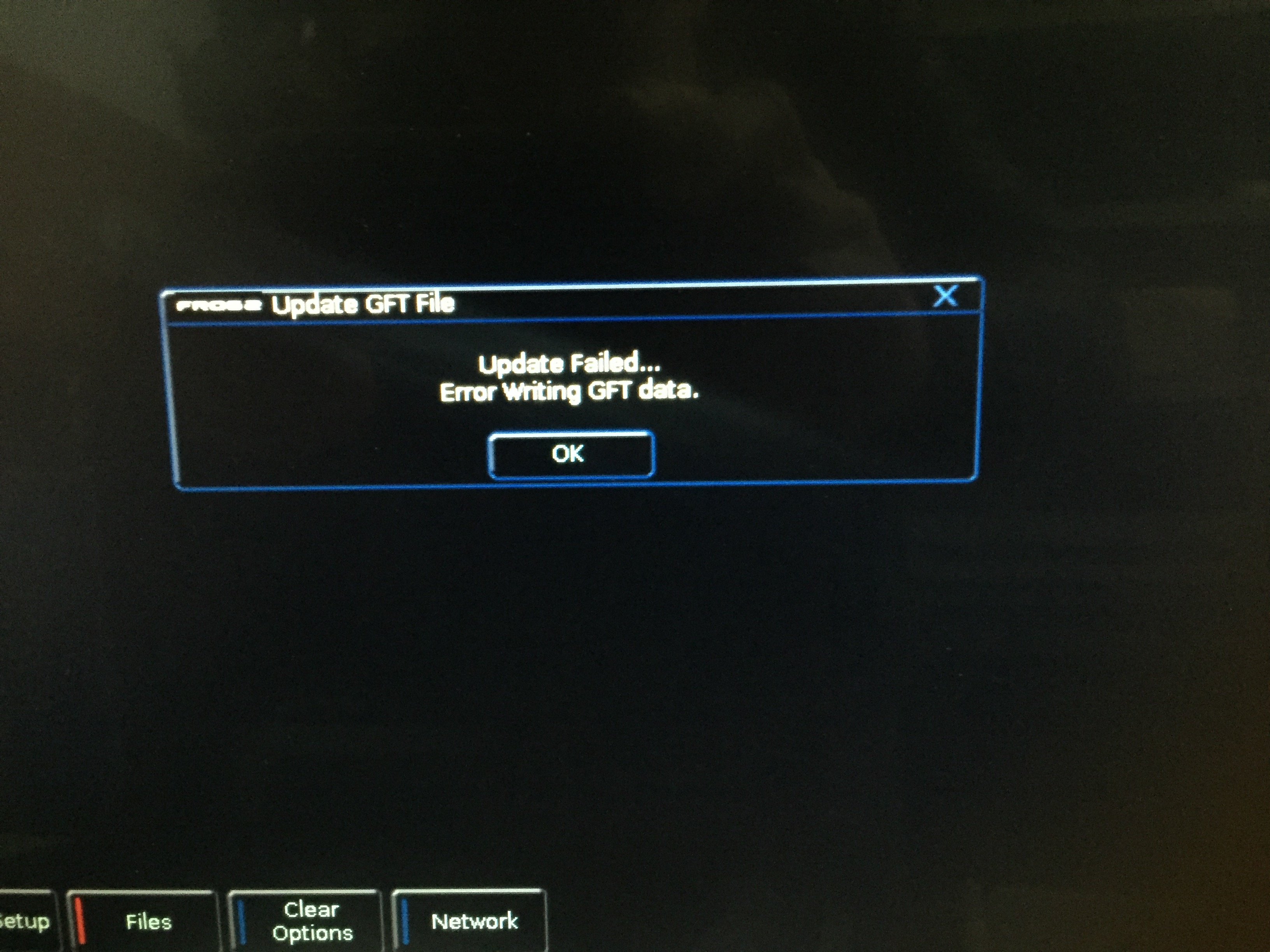

Hi Piero,
Thank you for letting me know. What Fixture Library has ZerOS 7.8 got with it? As it is such a long time ago that software was released, maybe Fixture Library 33 is too large for ZerOS 7.8. Fixture Library 33 is definitely compatible with ZerOS 7.8.2.39, so it’s probably worth updating.
I will check when I’m next in the office for you.

Hi Piero,
Glad that worked for you. If you need fixtures adding to your FROG2 that aren't in Fixture Library 33, you can use our Fixture Editor software to Import them from the latest Global Fixture Library from the website (currently version 35), and then load them into FROG2 manually.
http://zero88.com/forum/files/file/10-fixture-tools/
Hope that helps, any queries let me know.
