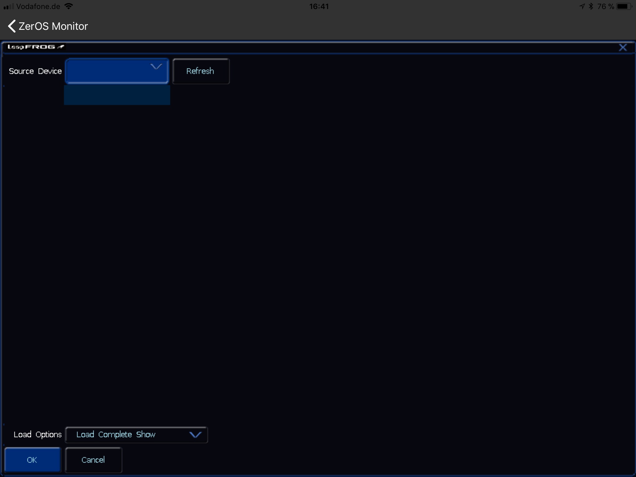

Mathias Boschen Posted February 14, 2018 Report Posted February 14, 2018 Hello, we got a Leapfrog 48 updated to SW 7.9.3 the desk works fine so far but we got issues saving our show to usb-stick. after programming our show the the desk wouldn‘t show any usb-device in the „save-show“-window. pressing the ‚refresh-button‘ can‘t help after restarting the desk it works. Looks like the desk will lose its usb-driver and needs to be restarted to get it back. Greeting from Lilienthal, Germany Mathias Quote

Mathias Boschen Posted February 15, 2018 Author Report Posted February 15, 2018 Hi Edward, I tried pressing refresh minutes after plugging the stick in. Once i plugged the stick before programing the show an try saving the show at the end of my programing. After restarting the desk, the stick will be shown in the menu, but a few minutes later he will not. So i had to restart again. It looks like the desk will lost usb connection a few minutes after restarting. Edit: i tried unplugging and ‚replugging‘ several times without success. Only restarting the desk will help Mathias Quote
