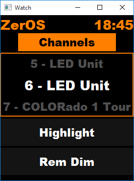

Jon Hole Posted March 16, 2017 Author Report Posted March 16, 2017 Thanks for the feedback - keep it coming. I think the real advantage here is as a focus tool. I struggle to see the need to have playback functionality from your wrist (although, potentially the current cue, and any fade / wait times and progress bars could be useful for crew backstage?). Rather than using the digital crown to fade up / fade down, what do you think about just using the programmer time on the console, and then Rem Dim / Highlight would use this time - meaning you can still just press "next" rather than having to fade down the previous channel, select the next channel, and then fade it back up. To change selection, if there are difficulties in using the Digital Crown (need to investigate this) how about press and hold the next / previous buttons to scroll through the channel numbers, and the when you let go, we action the Highlight / RemDim (with the programmer time if enabled). Lastly, I think Next / Previous would only select static fixtures, not Moving Lights. If a selection has already been made, Next / Previous would cycle through that selection in the order they were selected (so if you knew you were focusing channel 7, then 10, then 12, then 15 you could just select those fixtures on the desk / phone app, and then using the Watch to cycle through those four channels). Thoughts? Quote Jon Hole linkedin.com/in/jonhole
Edward Posted March 16, 2017 Report Posted March 16, 2017 I think pre selecting fixtures may be the best way to do this. That way you can record a "Focus Group" that has all fixtures you need to focus in the order you want to focus them in. For example not necessarily incrementing in channel numbers, but the logical way you want to move round your lights with a ladder/ tallescope. Before focusing you can then press this group, and then have your Next/Previous buttons to cycle through these fixtures. Using the programmer time on the console is a good idea for RemDim/ Highlight, however potentially the digital crown could be used to set this time too? If you then come to a fixture you haven't included in the focus group, swiping left can then bring you to the simplified keypad for manual control, but potentially then use the programmer time? For example 1 @@ fading at the programmer time? If no fixtures have been selected, I agree I think pressing and holding Next/Previous to cycle through would be the best option, as the digital crown has the potential to be fiddly for this anyway. In terms of playback I agree it is very unlikely you would want to use the watch to actually playback the show, however having the ability for example the DSM or SM to have it on their wrists may be quite a nice feature. Swiping right or having a different user mode is a possible way to do this? My only thinking is whether Groups should also be accessed from the watch. To check your front wash after focusing the last fixture you can select your group, rather than go back through and find channel numbers. If so maybe this is what window should appear when swiping right. Interested to hear everyone's thoughts! Edward Quote
Jon Hole Posted March 16, 2017 Author Report Posted March 16, 2017 Maybe this style interface would work better? One for individual channels, one for groups. Quote Jon Hole linkedin.com/in/jonhole
Edward Posted March 16, 2017 Report Posted March 16, 2017 That's a better idea. Scrolling through rather than pressing Next/Previous is a much nicer user interface. Could we still have a small keypad with this? Edward Quote

Jon Hole Posted January 30, 2018 Author Report Posted January 30, 2018 Well, who knew this small project was going to take so long! But discoveries and lesson's we've learnt along the way have created some positive changes to our whole App lineup, across iOS and Android too. We'll shortly be ready to enter public Beta Testing of our Apple Watch app - if you'd like to be part of this, please email me with an email address that's accessible on the iPhone which your Apple Watch is paired to. Here's a sneak-peak: Quote Jon Hole linkedin.com/in/jonhole
