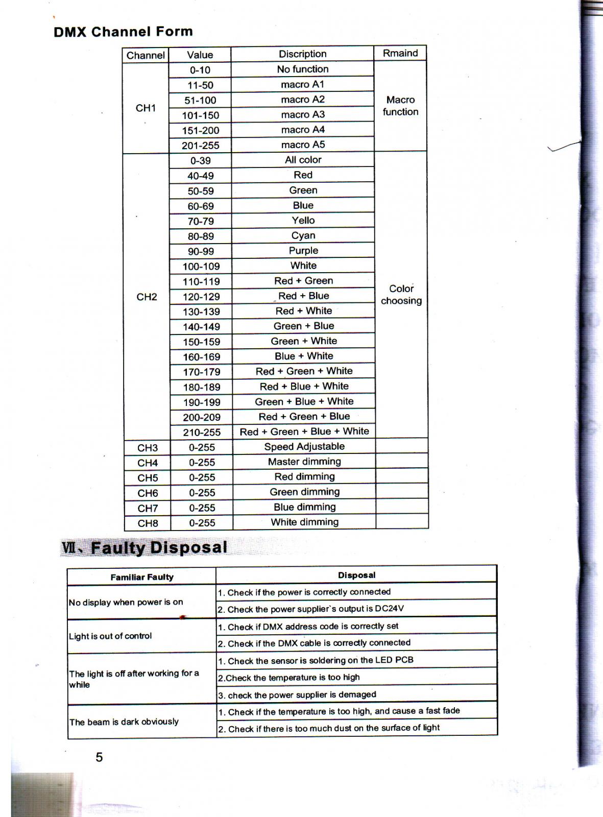

I have led the Chinese lamp is par-64 instruction.
Help please set this Device the table
Leap Frog 48 & 96 as it is at all possible.
I enclose an extract from the instructions.
I am sincerely grateful for the help.

Thank you received your investments. With respect to the manufacturer of the device, it is known only from China. No name of the manufacturer, device name, device behind small print says Paent №201430369333.2 all. I'll try and then tell about the work.
