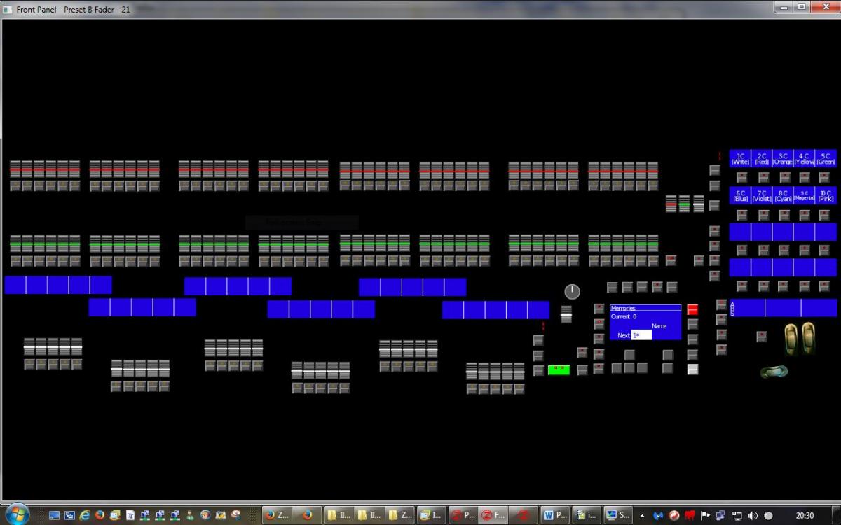

thistle2015 Posted December 22, 2015 Report Posted December 22, 2015 Hi, I've just installed the Phantom ZerOS on my windows 7 PC. The program seems to be running OK but I can't adjust the size of the Front Panel View. So it's really difficult to read the LCDs. Am I doing something wrong? Any assistance is greatly appreciated. I've tried adjusting the screen resolution but that changes everything globally. Cheers Quote

thistle2015 Posted December 22, 2015 Author Report Posted December 22, 2015 Hi Jon, Thanks for the advice, but it was the desk front panel I was refering to. I've tried changing my resolution to 1024x 768 but I still can't really read the LCD info above eack MFK button. I've attached a screen clip so you see what I'm on about. Cheers Quote
