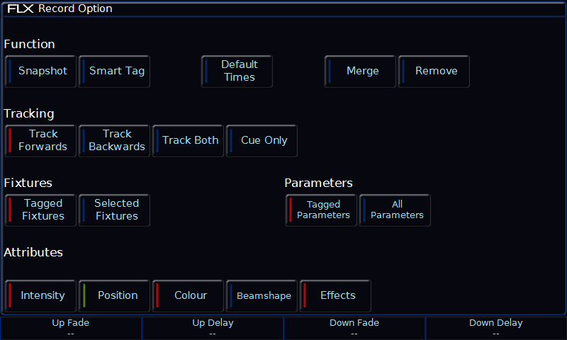

To filter what's being recorded into a cue in the first place, you need to use "tagging" and the record window.
In the record window, under the "attributes" heading, you can choose which attributes to record.
Green means all parameters within this attribute (as per position below)
Red means tagged parameters within this attribute (as per intensity, colour and effect below)
Off (blue) means no parameters within this attribute (as per beamshape below)
