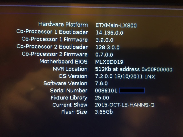

Lampie Leight Posted October 20, 2015 Author Report Posted October 20, 2015 The display was bought on-line from box.co.uk last week and it arrived yesterday. Sorry for the delayed response Jon. Here are our Solution desk details... Quote
