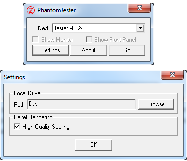

mark_topbarman2004 Posted February 28, 2015 Report Posted February 28, 2015 Good afternoon, I attended the course on Tuesday. Since I got back I have been trying to load the custom fixtures and latest fixture library into the phantom jester deck. I have saved them to the root directory of a usb stick and have made sure that the settings points to that stick. When I try to load the fixtures it says no files found. any ideas what it could be I have download the latest copy of the phantom desk. many thanks Mark Quote
Jon Hole Posted February 28, 2015 Report Posted February 28, 2015 Hi Mark, It sounds like you've done most things but I've listed everything here for completeness. Have you downloaded the correct version of the library (the "filtered" version). You can download it here: http://zero88.com/support/index.php?/Knowledgebase/Article/View/58/ Have you pointed Phantom Jester to your USB stick? It do this by clicking "Settings" in the small Phantom Jester window: Are you going into Setup (SHIFT+MODE), <Update Fixture Lib>, <Update Library> What size memory stick are you using? We know sometimes the Jester hardware struggles with larger USB sticks (try one that's 4GB or lower) Hope this helps, Jon Quote Jon Hole linkedin.com/in/jonhole
