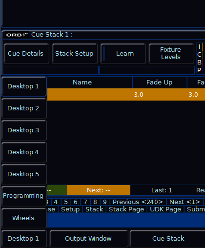

You should be able to just click the "Desktop 1" button on the bottom left corner of the screen, and then choose another Desktop. The "Programming" desktop is the one you are looking for I think.
