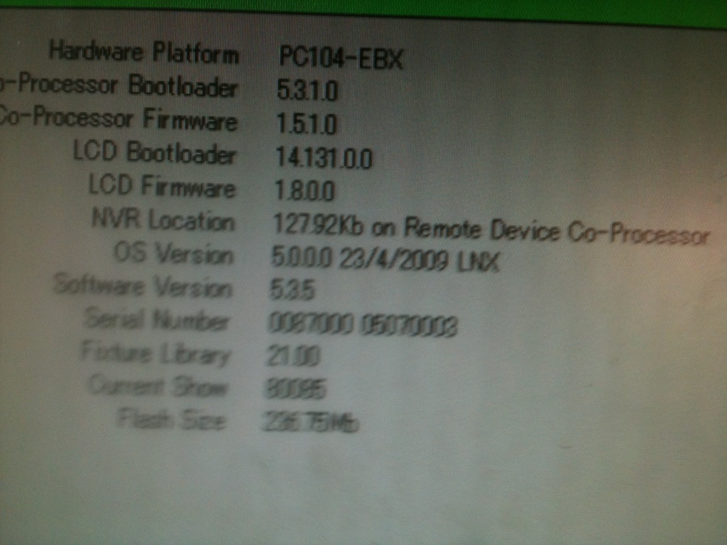

We've been using a used Frog 2 here at our Luau show for about 7 months now and last night when one of our Techs was firing her up we got green lettered "WARN" indications during PORT searches for PORT's 10, 4 and 11 and also timeouts with the same. Then when the load screen closed, the cue stacks and patch info were gone! I'd changed the battery back when we acquired the console and began programming maybe a year ago? I'll try and attach some pictures I took of the load screen and the Desk Info. Mahalo in advance for the help........

Hi kalamaku,
I notice your Software is very old - the first thing I would do is make sure the console is up to date (this is a free download).
If there was a definite problem, the console would say 'Error' instead of 'Warning'. Is there any problems you can see with the console, apart from the fact that it's lost the show file?

Hi Kalamaku
The ports 4, 10 and 11 relate to the internal serial ports used on the PC104 main board inside the desk. Due to the design inside the desk, the WARN errors are normal - it's an advisory that it's trying other port numbers, nothing to worry about.
