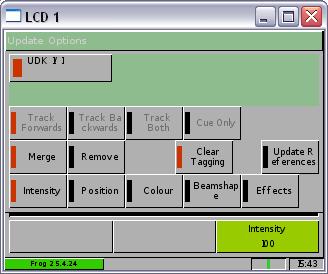

pierotec Posted October 27, 2010 Author Report Posted October 27, 2010 in particular update on the UDF and UDK. using the graphical interface on the touchscreen, the sintax is not complete I hope I was clear thanks Quote
Jon Hole Posted October 27, 2010 Report Posted October 27, 2010 I can't replicate this problem, sorry. If you have time, if you could take a photo and either email it to me or attach it in a reply to this thread, it would be greatly appreciated. Many Thanks, Quote Jon Hole linkedin.com/in/jonhole

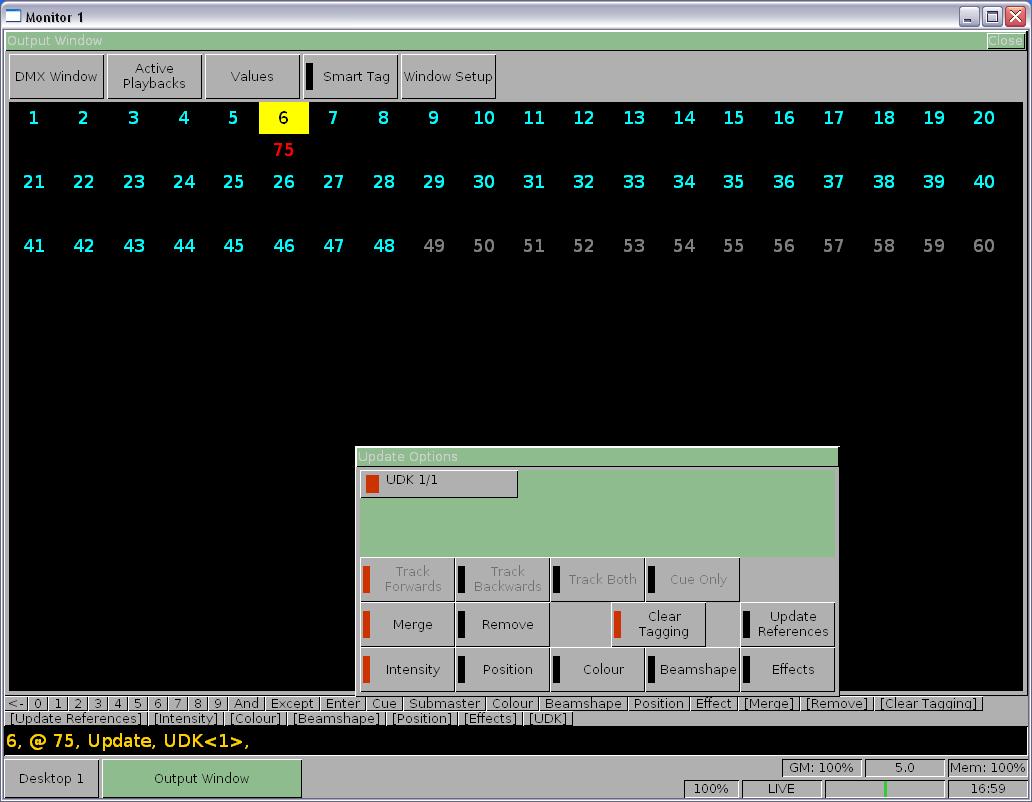

Jon Hole Posted October 27, 2010 Report Posted October 27, 2010 Attached is what I see when I update a UDK... is it the same? Quote Jon Hole linkedin.com/in/jonhole
pierotec Posted October 27, 2010 Author Report Posted October 27, 2010 yes, but the release is 6.0.0. selecting UDK 1/1 the button not turns red, and the command line turns red for error sintax Quote
Jon Hole Posted October 27, 2010 Report Posted October 27, 2010 Sorry, I didn't realise I was still using a beta of Phantom. However, I have upgraded to 6.0.0 and this still works fine. Here is a screenshot of Monitor 1 while updating a UDK. Quote Jon Hole linkedin.com/in/jonhole
Jon Hole Posted October 27, 2010 Report Posted October 27, 2010 Ahhh I see - we'll look at this tomorrow when I'm back in the office. You can press UPDATE and then press the actual UDK and this is accepted in the command line. Many thanks for taking the time to post the screenshot. Quote Jon Hole linkedin.com/in/jonhole
