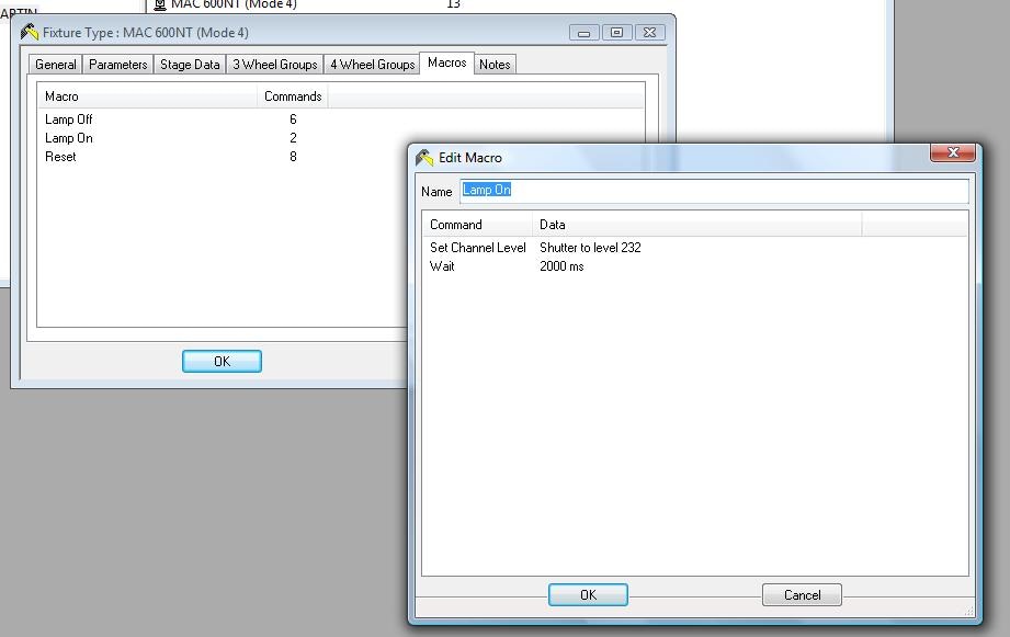

In the Fixture Type Editor program.
For martin mac 600 e nt there is a tab called macro.
There are listed DMX codes that will light the lamp. turn off the lamp and reset the fixture.
Where can I find this macro function on the fat frog.
thanks
JMH,
The FatFrog does not have a macro function. The macro function is only avaialable on the newer desks - Frog2, ORB, maybe the new LeapFrog. The fixture editor is common to all of the Zero88 desks supporting moving lights, but some of the attributes and functions (like macro) only relate to the newer/higher spec desks. The fixture file written out for the FatFrog excludes the data items that desk can't use.
