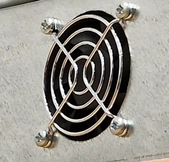

There is another possible cause of the noise, the earlier units the vents for the fans were punched out of the metalwork as slots.
This left the edges of the slots saw-toothed which can give excessive air flow noise.
On the later units the vents were replaced with a round edge fan guard.

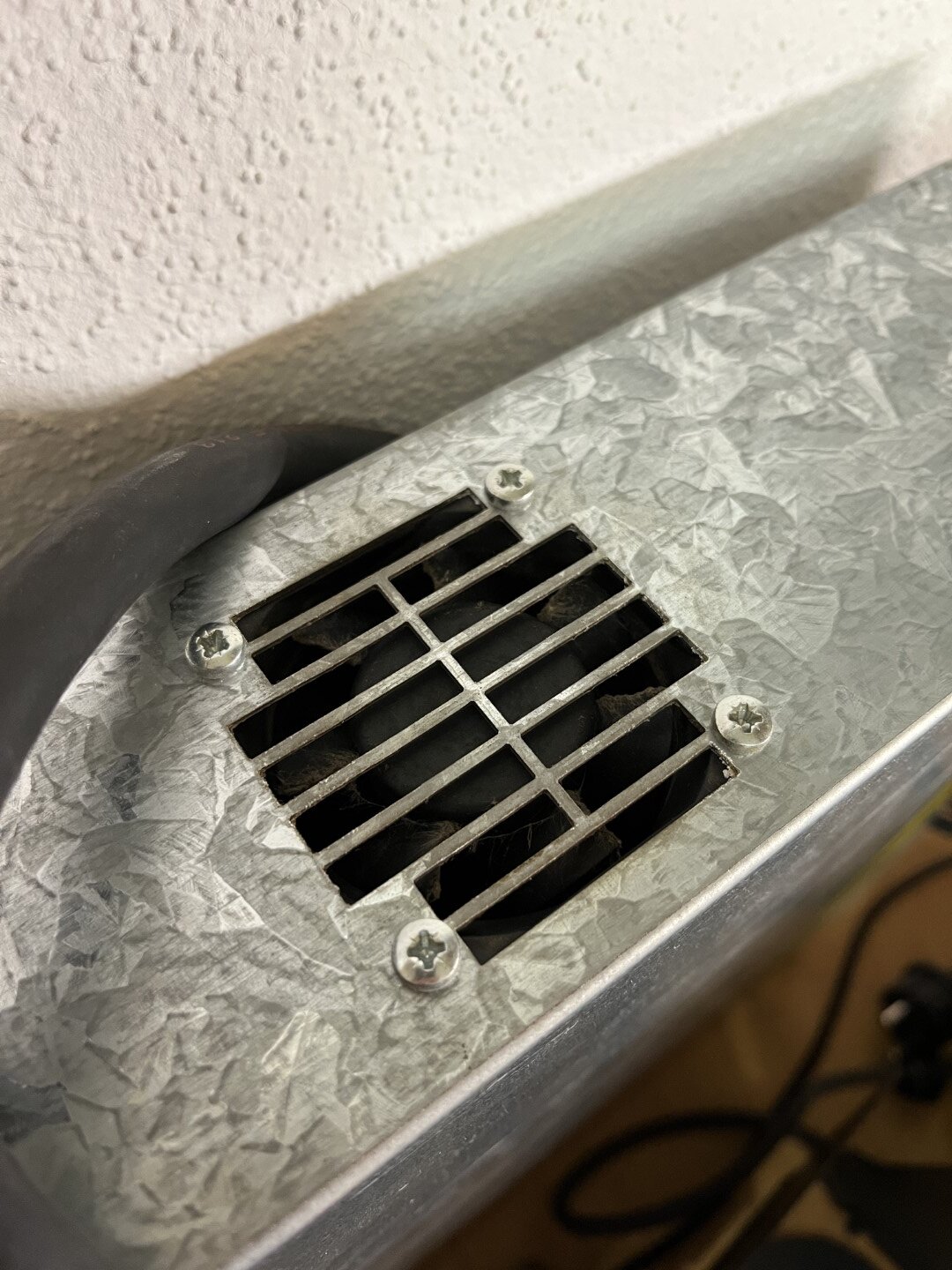

Many thanks for your responses.
It looks like I have a unit with the old vents (see picture).
Nevertheless, I would like to replace the fan. Do you have a recommendation for a more quiet model?
I think you'll find any newer fan will be quieter because the bearings are new. The important thing is to match the overall size of the fan & it's voltage - there's probably a label on the noisy fan that will have a part number that can be googled. You will probably see listed as accessories for the new unit - the wire grill that Keith showed - some decent side cutters will remove your old grill & the existing screws will hold the grill and fan in place or replace with suitable nuts & bolts :D
