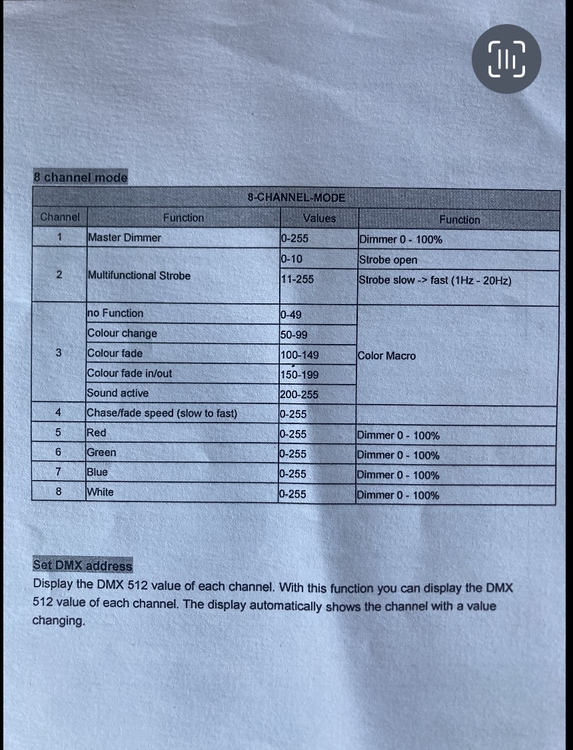

jeansté Posted 5 hours ago Author Report Posted 5 hours ago Thanks for your help. I don't get there until the last minute and I won't have time before the show. I'm hoping to be able to get some things ready beforehand. here's what I received. If you could do this for me, you would be doing me a great favour. Thanks in advance. Quote
kgallen Posted 4 hours ago Report Posted 4 hours ago @jeansté Thanks for those. Have you a manual for the profile? Quote
kgallen Posted 4 hours ago Report Posted 4 hours ago @jeansté COB PAR 200 and TV Mini Fresnel done. Put on a USB stick and Load as you would a showfile. When patched, they will be in a red font in the fixture list. FOS.ift Quote

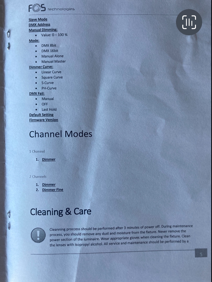

jeansté Posted 4 hours ago Author Report Posted 4 hours ago thank you very much!!! here are the profiles. I was thinking of patching them to 16 bit dimmer Quote
kgallen Posted 3 hours ago Report Posted 3 hours ago I’ll do you a fixture in a bit so you can use that 16-bit dimmer mode properly. Quote
kgallen Posted 1 hour ago Report Posted 1 hour ago @jeansté Here you go, all of them in one file. I'm sure the 1ch profile fixture is not much use over just patching a generic dimmer, but at least it would have the right name. The 2ch version has 16-bit dimmer which will benefit you if you are programming a cue stack (but note if you are busking on a fader then you will get 8-bit resolution). Let me know if you have issues with them or you spot an error. Enjoy! FOS.ift Quote
