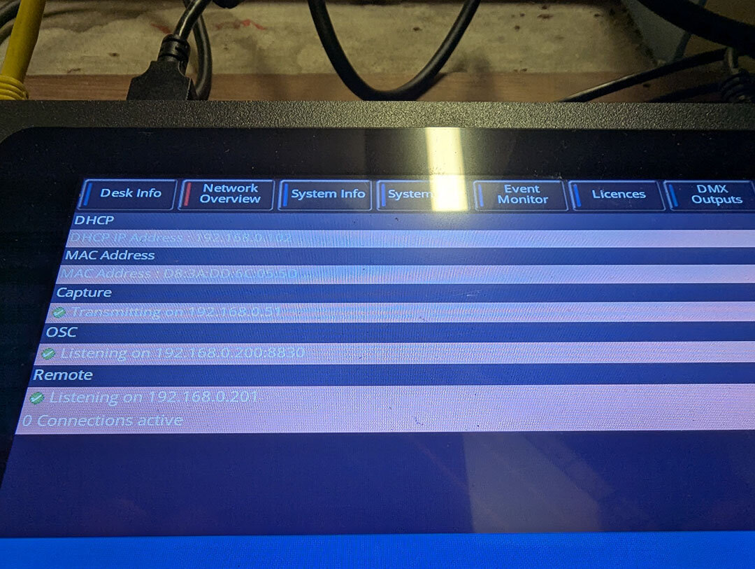

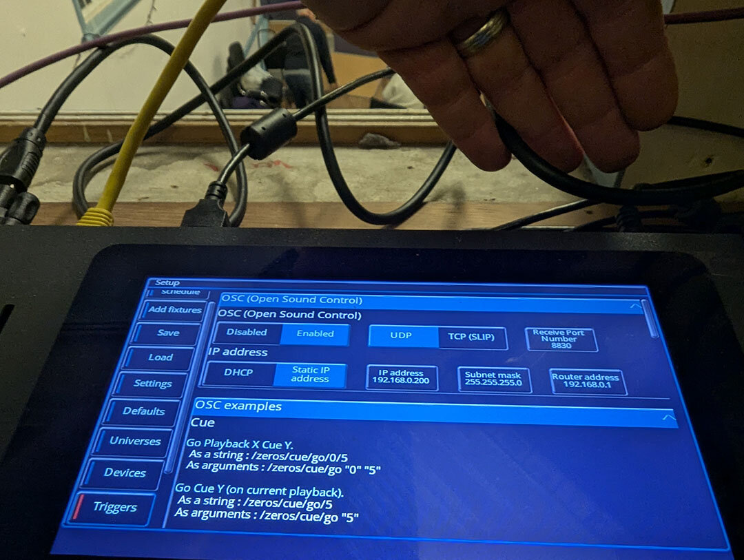

All the network settings are configured and OSC is enabled in the settings as can be seen in the images.
We know the network is operating correctly as we can control the FLX S48 using the Remote APP.

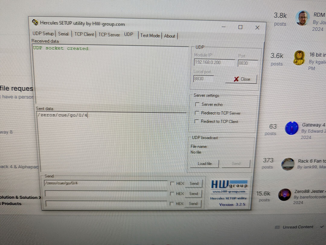

We have tried using SCS control software as well as terminal software but nothing seems to be working.
Have tried the following commands:
/zeros/cue/go
/zeros/cue/go/0/4
/zeros/playback/go
