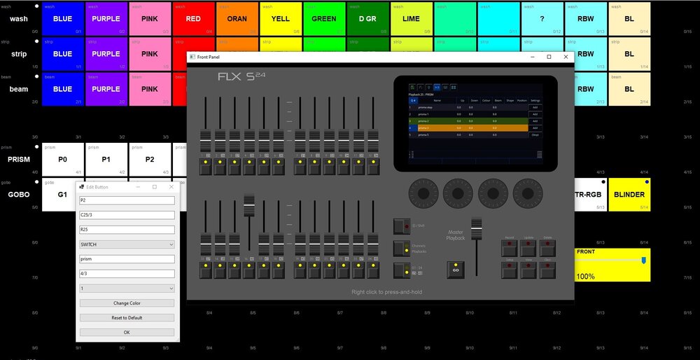

Hi, friends. I'm creating a simply custom touchscreen (inspired by chamsys)  for Windows based on OSC.  I will provide it for free soon. Any ideas for improvements?  Includes faders, button settings, button grouping, playback and cue triggering and releasing.

Looking at the view of PB25 he's triggering cues within PBs. That edit window refers to the button which has triggered cue 25/3 (cue 3 in PB25).
I'm more interested in the edit window itself, this doesn't look like touch OSC so, what are you using @Tomas Pokorny?
2 x FLX with Raspberry Pi's running TouchOSC, ZerOS Wing, Leapfrog, Jester M24L Eurolite ArtNet/sACN nodes.
Yeah I was thinking along those lines. Interesting idea for sure
@Charlie Newman It's what I do with OSC. You use less PBs, you get the option to cross fade rather than snap and you don't build up a stack of active PBs.
