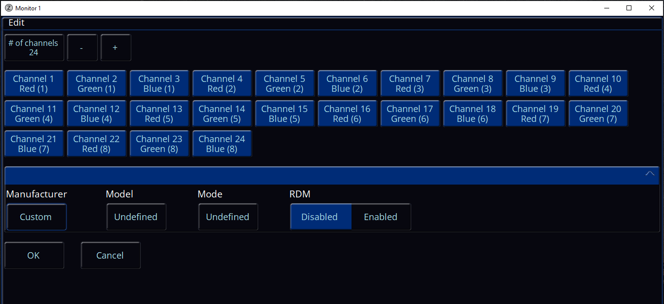

Personally looking at the manual I would run them in 192 Ch Mode, and then create a custom fixture profile for each strip, something like this (although there is already a Zero88 profile for these units in the desk)
This way you could patch this 'custom fixture' for each of your strips, easily run FX across all 24 strips, or dive into the multicell control and run FX on each individual strip. This should also avoid the complexities of trying to work out what 'cell' 1.28 is compared to cell 1.49 for example if you were to use the Z88 provide fixture profile.
Hopefully ZerOS 8 will be out well before your show, so you should have plenty of disposable DMX channels to play with!
