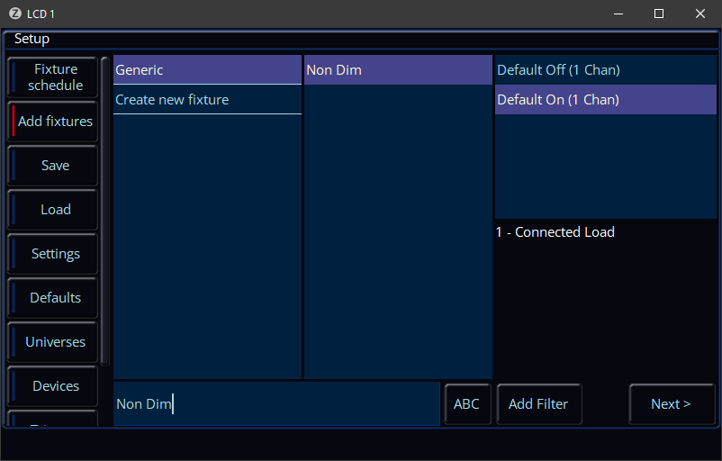

Edward Z88 Posted January 15, 2024 Report Posted January 15, 2024 Hi @Simonkbike On 1/13/2024 at 11:26 PM, Simonkbike said: What's the best way to patch this on my desk? I would recommend patching the relay channels as "Non-Dim" fixtures, which can be found under the "Generic" manufacturer in Add Fixtures. The nice thing about this, is there are two variants of this fixture - Default On and Default Off. For example, if you want the relay channel to be powered as soon as the console is active, you could patch a Default On. This would still provide the ability to then switch it off if required. On 1/13/2024 at 11:26 PM, Simonkbike said: The desk wouldn't let me patch to a fixture channel above 48 so the pack will fill 4 more faders which they don't really need. On 1/13/2024 at 11:26 PM, Simonkbike said: I'd really like to move all the relays off the faders and patch as fixtures so I can switch with Beam On/Off. I would recommend patching the Non Dim fixtures to the Solution's MFKs, which are numbered as fixtures 101 thru 300. Once patched, you can then select the Non Dim fixtures on the MFKs, and under BEAM, you'll see the ability to switch the "Connected Load" using an encoder wheel. On 1/13/2024 at 11:26 PM, Simonkbike said: I've built this 4 channel DMX relay pack to switch on/off ancillary on-stage lights & effects which may be damaged by a dimmer output. In the picture I can't see any fuses between each relay output and its respective socket. If you are plugging in devices with a 3-amp fuse in the plug this is fine, but it would be best practice to ensure there is protection, in the event of a load with a 13-amp fuse being plugged into a socket. 1 Quote Edward Smith Formerly: Zero 88 Product Specialist - Email Support Currently: Obsidian Control Systems Product Specialist

Edward Z88 Posted January 17, 2024 Report Posted January 17, 2024 10 hours ago, Simonkbike said: I installed 7.14.2 this week but when I try to re-patch I can't find a non-dim profile. When I search, I still have a video 1ch profile available. Any suggestions? If you search "Non Dim" in Add Fixtures, you should see this... If you are still seeing the "Video" fixture in Add Fixtures, this suggests the fixture is included in the show file that has been loaded, and so has been added to Add Fixtures. As mentioned, the generic "Video" fixture is not included in Add Fixtures in more recent fixture libraries. Quote Edward Smith Formerly: Zero 88 Product Specialist - Email Support Currently: Obsidian Control Systems Product Specialist

Simonkbike Posted January 20, 2024 Author Report Posted January 20, 2024 For clarity, if you patch a new fixture. non dim profile is in the Generic list as expected. When I was re-patching my existing fader, the Generic list is filtered, hence "non dim" is hidden even to a Search. Once I'd pressed Clear Filter, all was revealed. S. Quote
