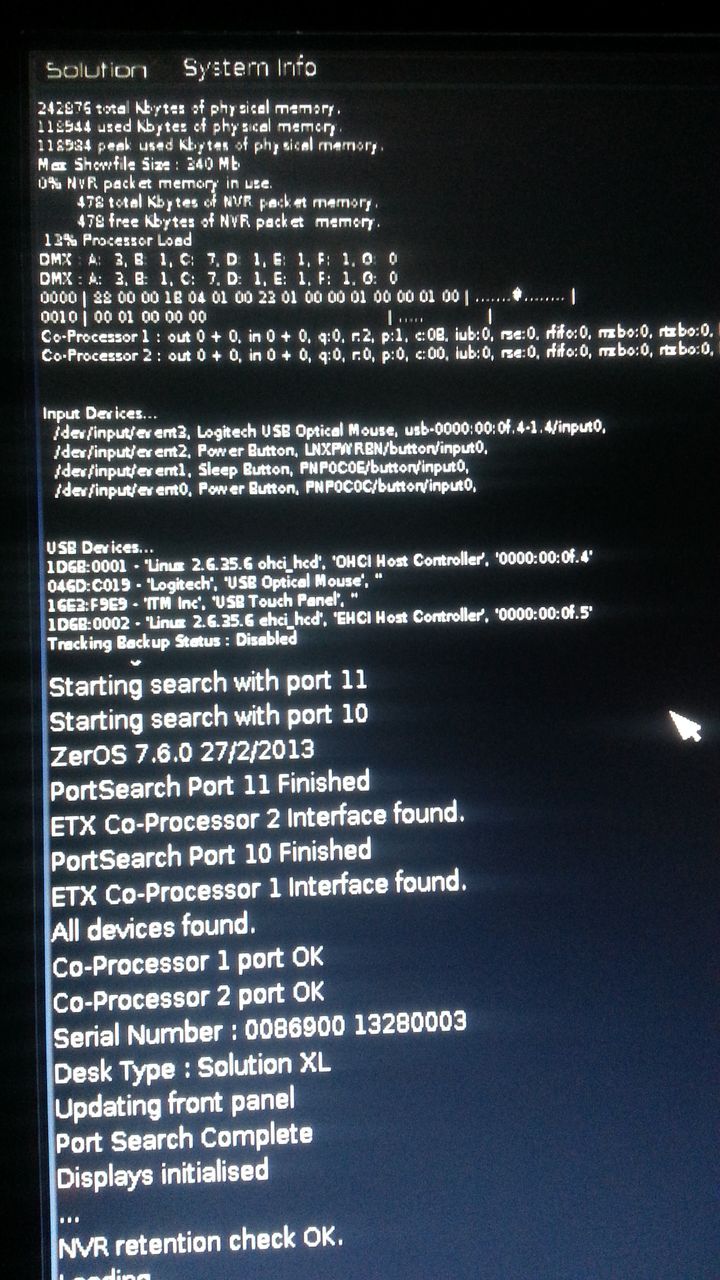

Hey Mike, thank you for your reply. First I updated the Solution to Version 7.7.0 today. But I was suprised that the console didn't accept the included Zero 88 USB Stick at booting the Firmware installation. I had to use another Stick. In the Software updating manual is written I should use the included Stick. But the new Software update didn't fix my problems with my Touchscreen. It still didn't work. Next I have tried your advices. I've attached you a screenshot of the System Information. Then I went into Input Capture, but there were only my USB Mouse an 3 Buttons to choose in the dropdown list. No Touchscreen available. So I think there is no driver for it included in the current Solution Software. What's next?
Hello. I've bought a LG T1910 Touchscreen for a Solution XL Desk because the Info for Compatible External Touch Screens - ZerOS Consoles says Currently assumed working: LG Touch (all). But it doesn't work. In the System Info it is detected as USB Touch Panel. But it can't be callibrated and no touch input is working. I have to get the Monitor working until the end oft the next week or I have to buy another one. It would be nice if you can tell me how much the chance is to use the LG Touchscreen with the Solution XL. Best regards. Fensch
