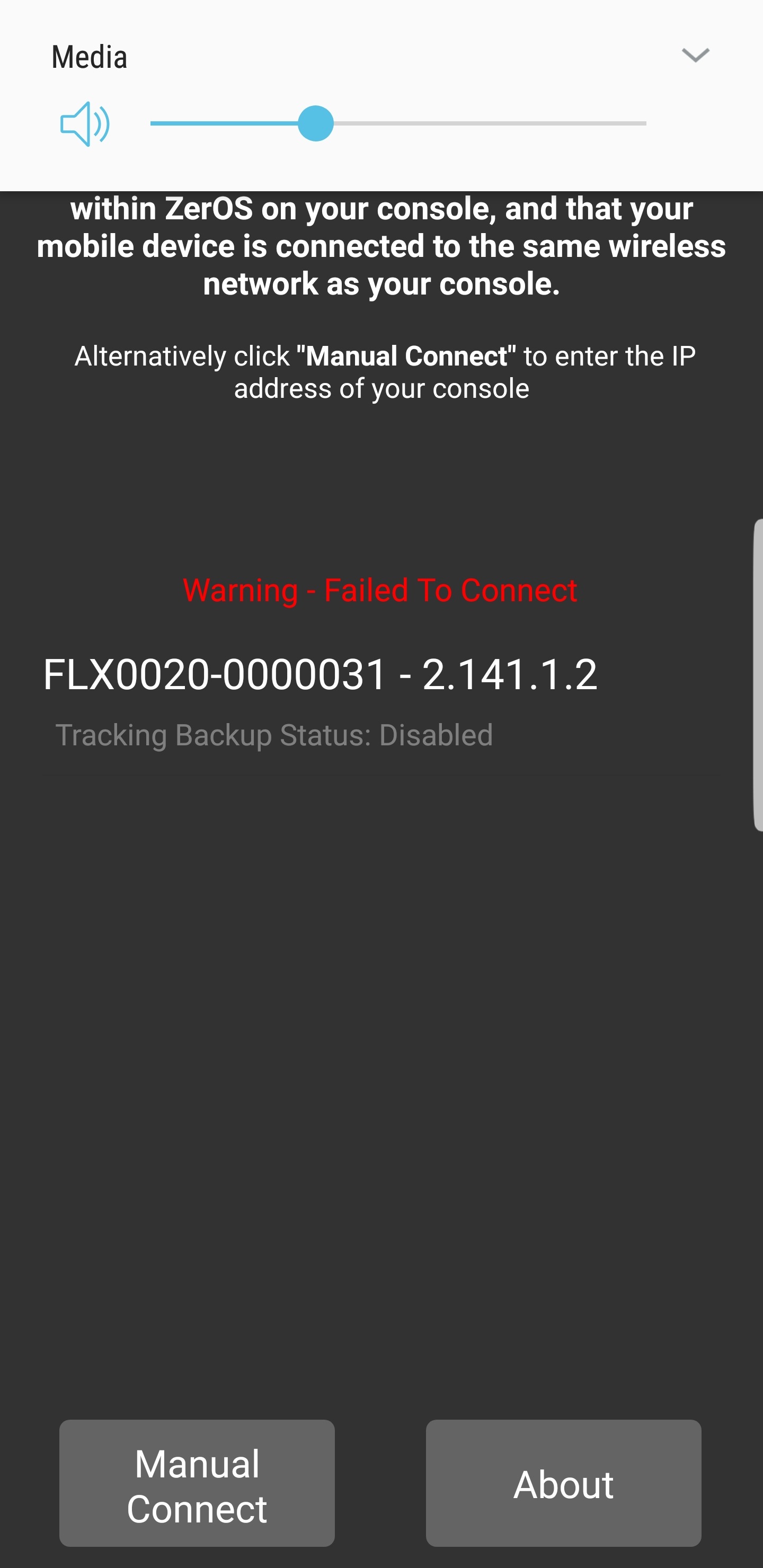

Hi Martin. Thanks for the pointer but I have checked and checked again. Tested on four routers now all on different ip ranges both with the desk on static ip and dhcp and different cat5 cables. Power cycling everything inbetween changing settings. I will try the beta remote and see if I get any joy.
Thanks Jon. Will give that a go tomorrow.

Do you know if this is a known issue as I see similar 'remote app' problems popping up on the forum?
i have had similar problems with the android app, this is since i updated to the latest Zeros release V7.9.4.9. what version are you running?
Hi I have an intermittent problem when connecting the remote app to my FLX desk, this problem has occurred since updating the software to V7.9.4.9. I setup remote options on my desk as follows: Enable Remote Disable security use DHCP I used to use a static IP address with settings of: Enable Remote Disable security IP - 2.141.1.2 Subnet - 255.0.0.0 Gateway - 2.141.1.1 other than my mobile this is the only device on the network. phone IP address is generally 2.141.1.21 (this is DHCP so can change time to time but it normally uses the first in the pool) the error my phone gets is attached. Also tried using another router with ip range 192.168.8.** with subnet of 255.255.255.0 this also had the same outcome. Any ideas? Note: this is since i updated the software. I have since installed it again just in case.
