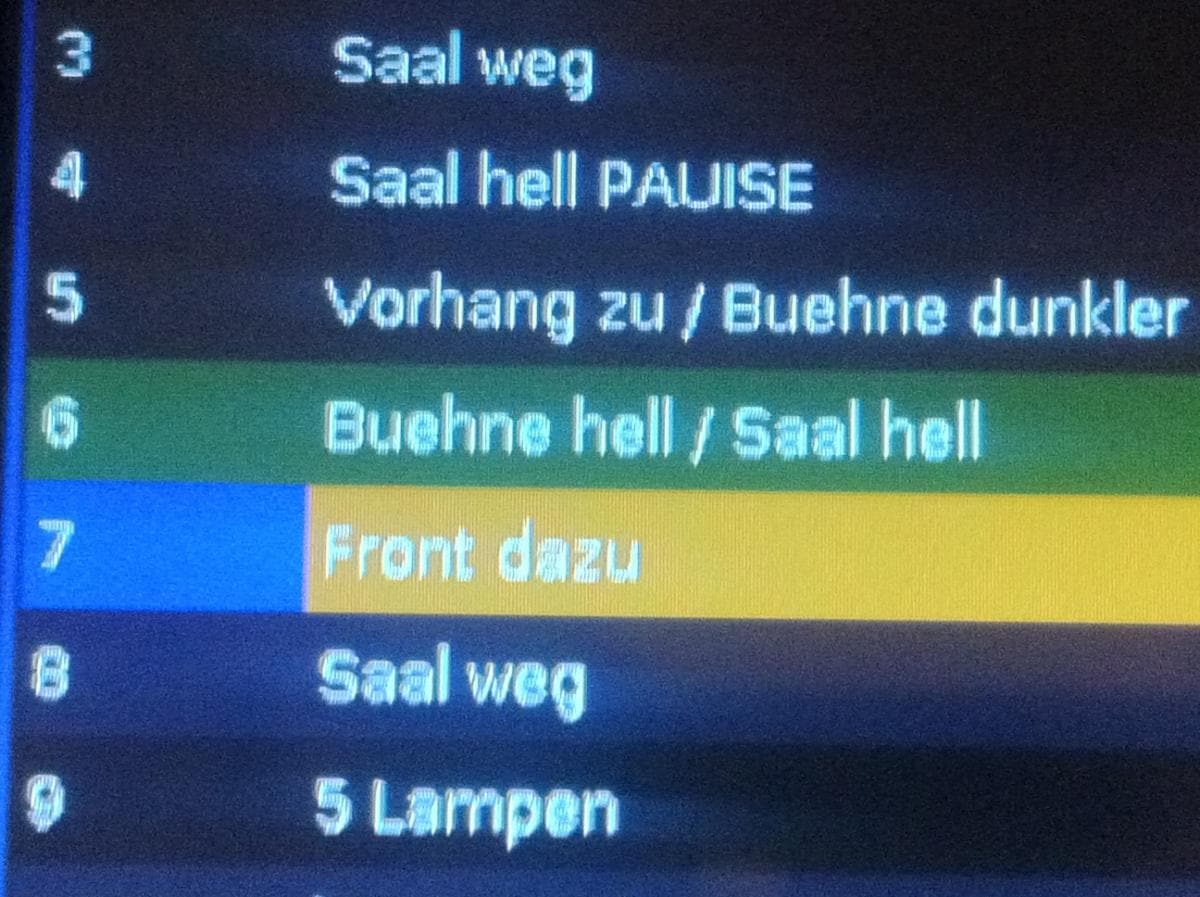

  4. On the on desk screen of the leap frog 48 the current cue is shown properly but for the next cue the description is not there. is this a bug ?
