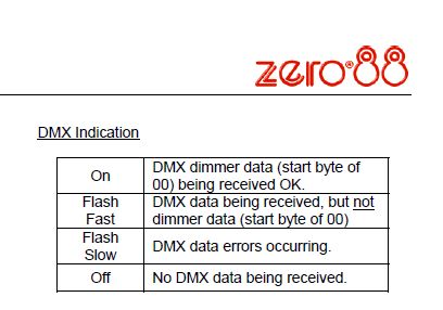

  18. Did you notice what the DMX LED was doing on the packs before you started replugging the DMX?

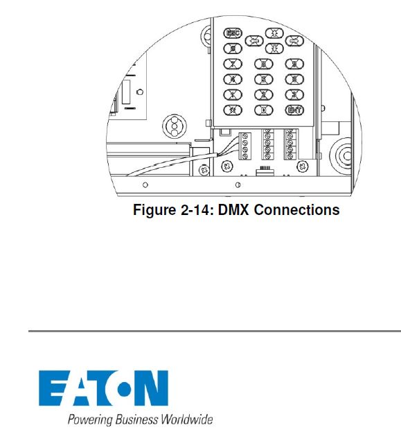

  19. The Chilli range of dimmers are installation dimmers so the terminals for all the connections that make it work are inside the unit. Doing so means that people who aren't sure what they're doing can't just plug stuff in (or unplug it). If you take off the front cover of the unit and look below the keypad you will see the terminals for the external control signals.. The DMX terminals are the left set of four - to get DMX out of the dimmer, all you need to do is connect a cable to these terminals to carry the DMX Through. This is all detailed in the manual for the Chilli dimmers
  20. No - you can't use a Cat5 converter - the Cat5 connector has CanBus signals on it and some of the data lines from the processor for updating firmware and doing diagnostics. There isn't a DMX output inside the dimmer - all you need to do is remove the cover, get a cable inside neatly and terminate the cable on to the DMX In terminals. They're screw terminals so easy enough to get another set of cables in to
