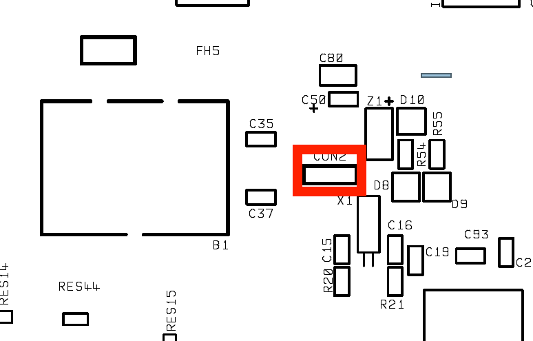

Hi Justin, First thing i would have looking at on this is the internal battery. Was there any signs of corrosion around the battery, discolour track etc. You should be seeing the battery voltage on the header to the right of the battery, the centre and left pin should have a jumper connecting the together. -
