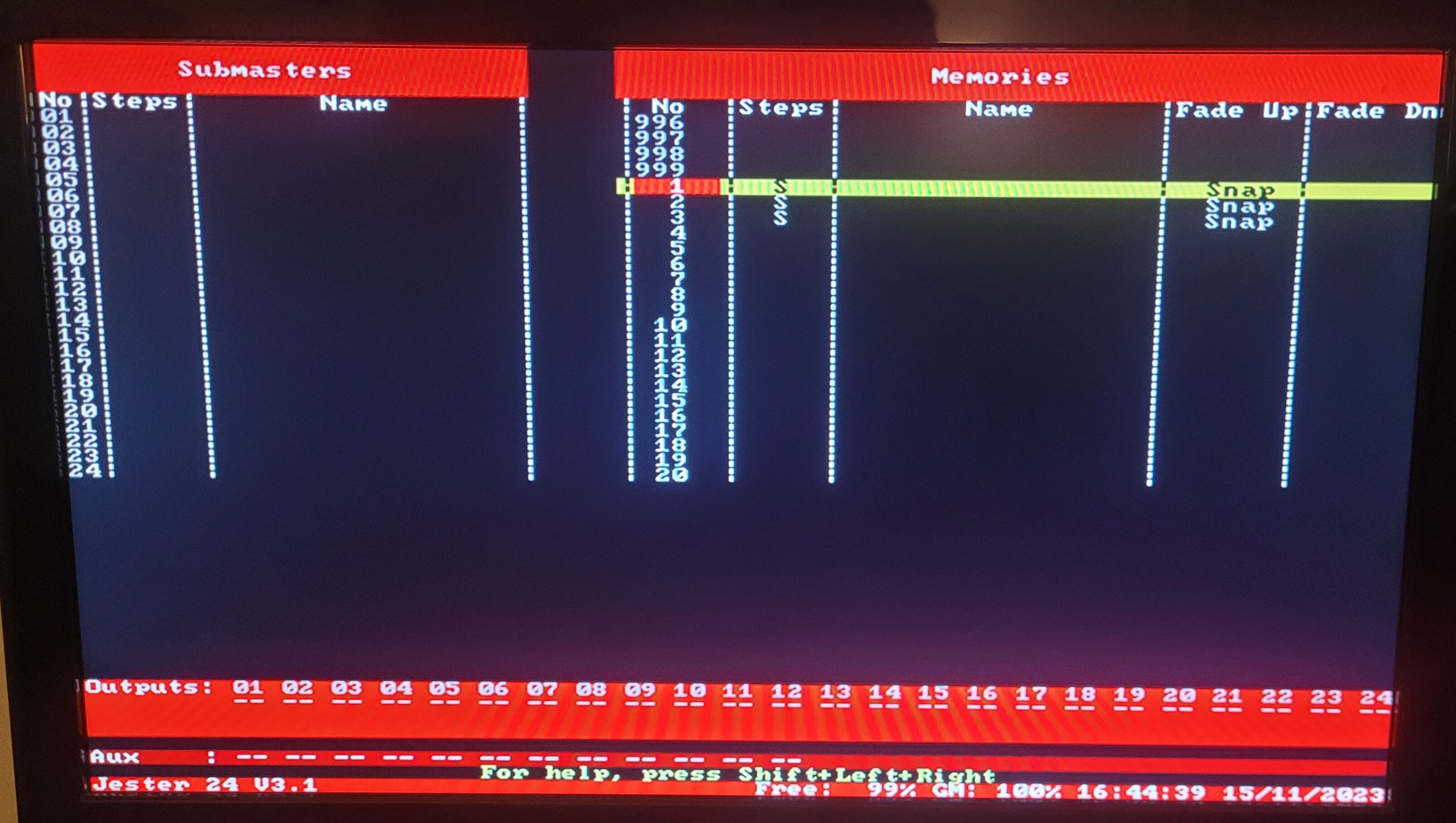

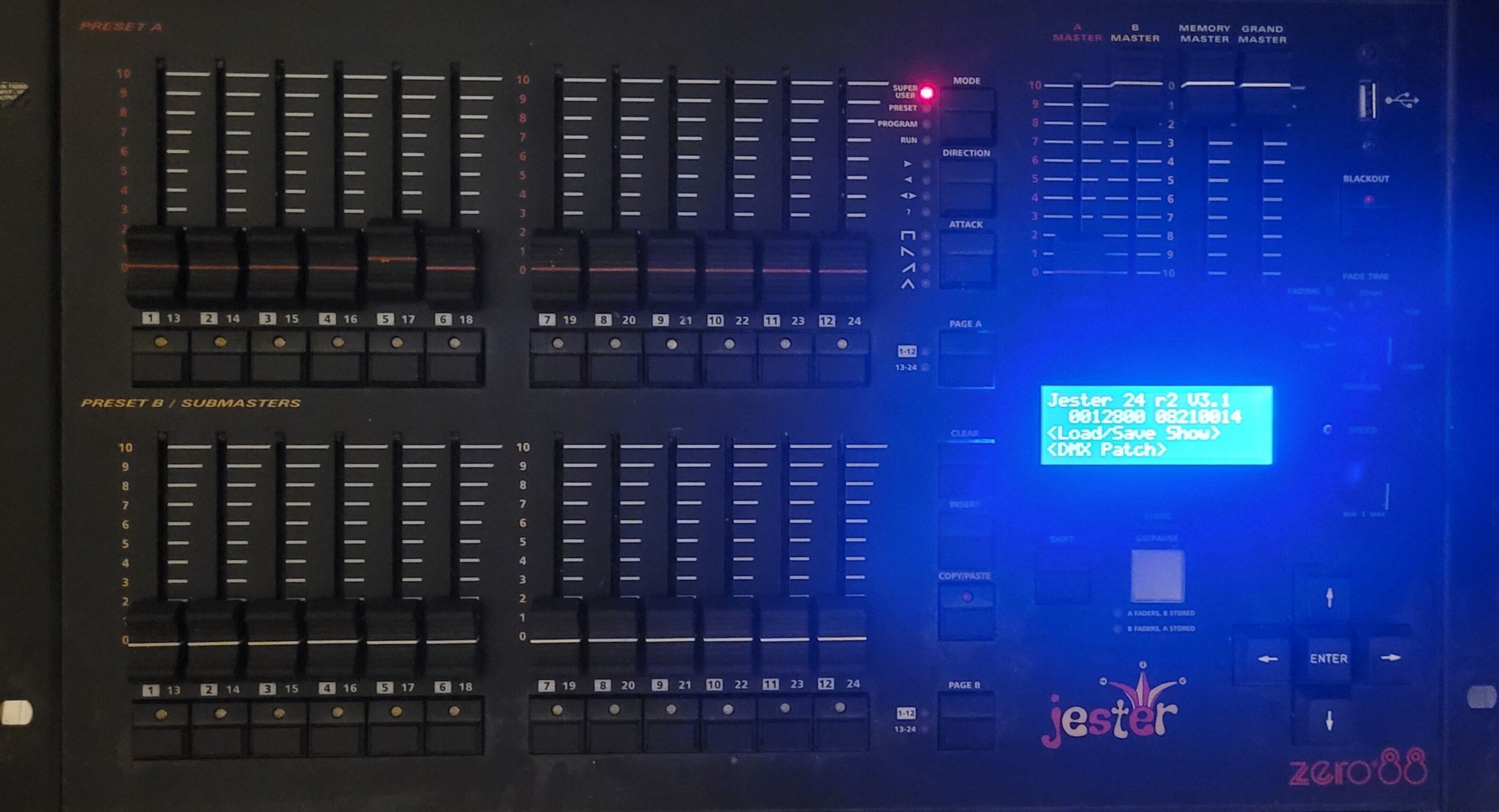

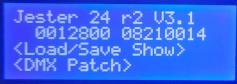

Recent Profile Visitors

  3. these are the pic ive got so far
