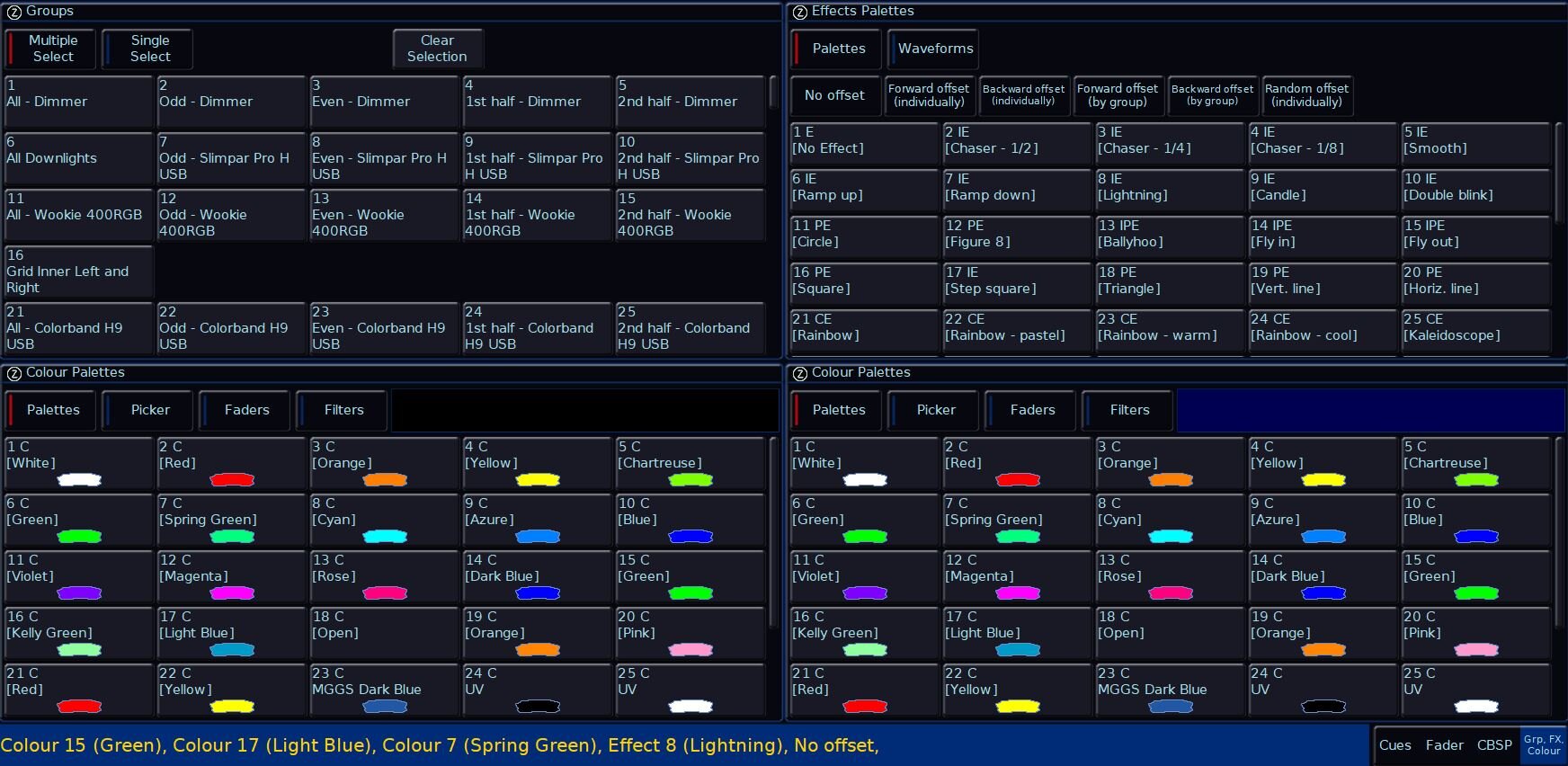

OK thanks last question today i promise! We have an attached touch screen monitor. We have checked the manual but can't find a way to re-organise the panes. We would like the Groups window to extend across, and the effects to drop down and replace one of the colour palettes is this possible? I have attached a picture to show what i mean. thanks -
