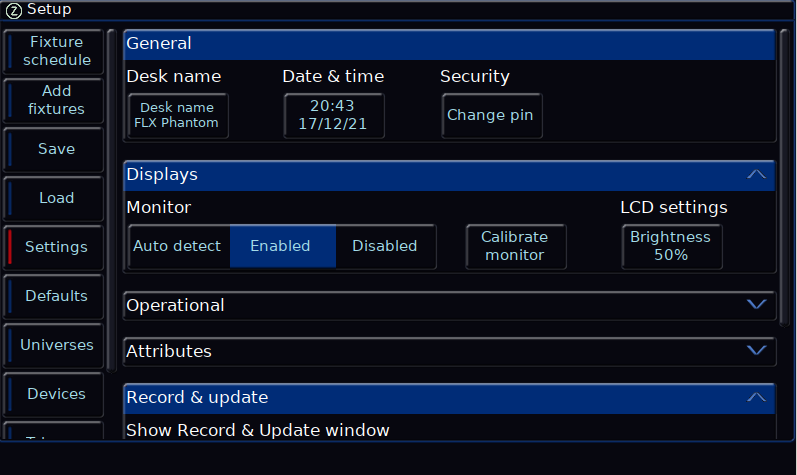

Hi Edward, thank you for your screenshot! I am still unable to find the resolution button on PhantomZerOS 7.9.9. I will double-check with our actual console asap and come back to you (i. e. to this thread). Have a nice weekend! Martin (alias "Kauz")
I am trying to attach a VGA monitor using an active DVI-D -> VGA adapter. Therefore I have to select the resolution manually. However, with ZerOS version 7.9.9 I am unable to find a list of options in the Setup. I just find "Auto detect", and "Calibrate". I believe Auto detect will hardly work with the adapter. Even though the monitor is old, I would like to keep it if possible. Its form factor, fits perfectly to our operator's room. Can anyone tell me how to set the resolution manually?
