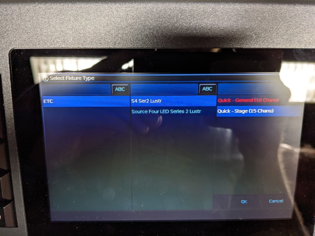

Hi, I am experiencing huge problems using RigSync on my FLX in my theatre. The infrastructure is as follows : two Showtec DB-1-8/RDM splitters are daisy-chained on output 1 of the FLX console with RigSync enabled. From the splitters, twelve DMX lines run around the stage, with 18 ETC SourceFour LED Series 2 Lustr (RDM-capable) connected to several of those lines. Every DMX line (including the one connecting the FLX and the splitters) is properly terminated. There isn't a non RDM-capable fixture connected anywhere. I tried connecting the FLX directly to each and every single DMX line running from the splitters and RigSync then worked fine. But when using the splitters, the FLX displays tons of error messages and some fixtures flash or do not respond at all. So all my suspicions point towards the splitters. I know one can't expect high-end quality of products with such a low price tag as Showtec splitters, but still I would expect to be disappointed by the build quality or the durability of the product, not by the absence of the advertised functionality... So I am still trying to convince myself that there is another explanation. Has anyone positive experience with those splitters with other RDM consoles/fixtures? Or with ZerOS consoles? Do I do something wrong, or should I throw the splitters in the bin and buy better quality devices? For now I've disabled RigSync, what allowed me to work, but since my theatre has a fixed rig I was placing great hope in RigSync for decreasing the portion of my time spent climbing ladders up and down... Regards
