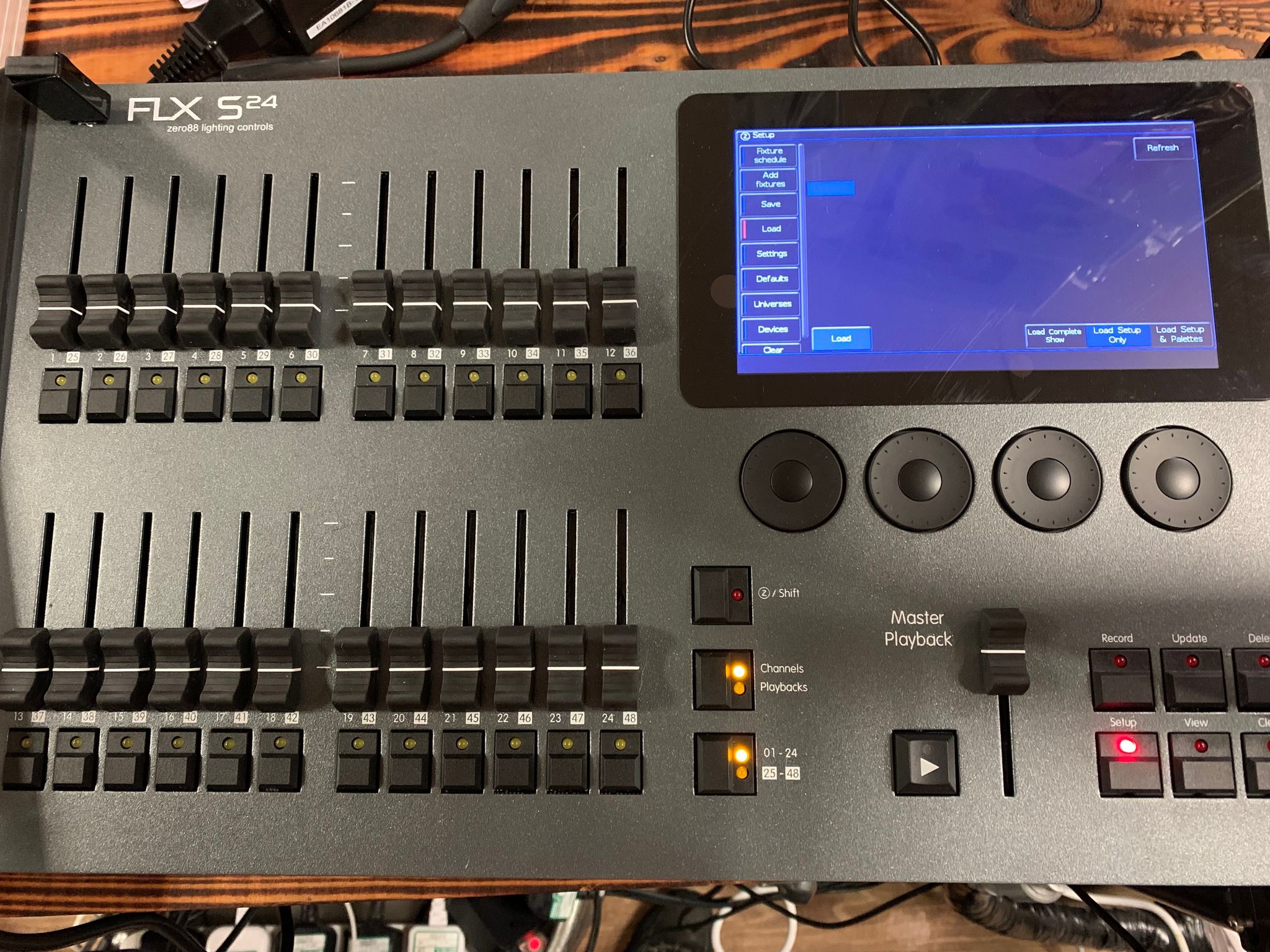

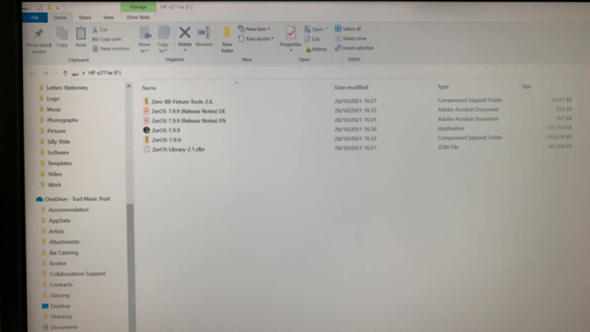

  1. This doesn't work Edward. When we've downloaded, copied the library to the root of a USB stick, plugged into the console and selected Setup > Load we are presented with a blank screen (image attached). In the list of Fixtures for Chauvet, there is no Batten Q15 option. We've downloaded the latest ZerOS version to try to get that installed, but we can't find any instruction on how to actually update the controller with that OS upgrade, assuming we're not already using this latest version (7.9.9). We assumed it would be a Setup > Load option but, facing a blank screen when we select that, we're a bit snookered. I'd put this down to not knowing what we're doing, but we have 6 fixtures and it seems ridiculous, to us, that it's this difficult to get them to even come on, using this controller. We've a show tomorrow night and at this rate we'll just have to put the lights onto their in-built auto-program mode so that we've at least something! Any help would be hugely appreciated. Thank you. NJ

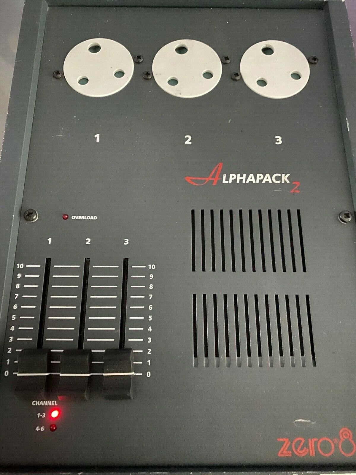

  4. Just bought a used Alpha Pack off eBay and, on trying it out, it's got quite a loud buzz between the 1-9 slider settings, but is completely silent or 0 or full. Is this normal? Can anything be done to reduce the buzz or do we just accept that it's lights on full, permanently, during performances? Thank you NJ
