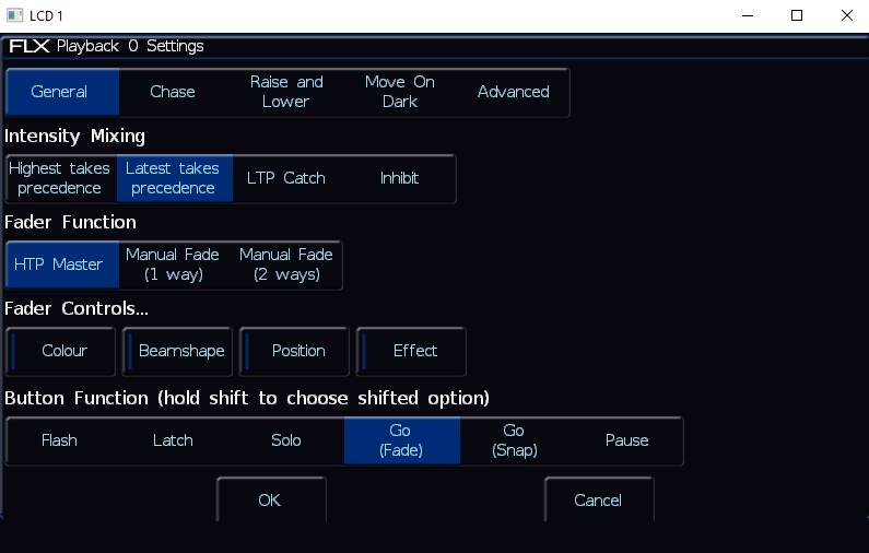

  2. This is my current settings. I just tried setting the GM to 100% and now when I highlight cue 2 and press Go it would just jump back to cue 1. Update: The Go button works but only if I set the GM to 0, press Go and set the GM back to 100.

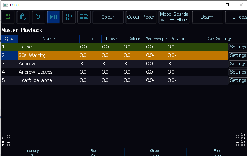

  4. I'm using the FLX S24 mode of the Phantom ZerOS 7.9.5 and I've recorded a few cues into the master playback. I've somehow managed to get the first cue playing however when I press Go it doesn't move to the second cue automatically.
