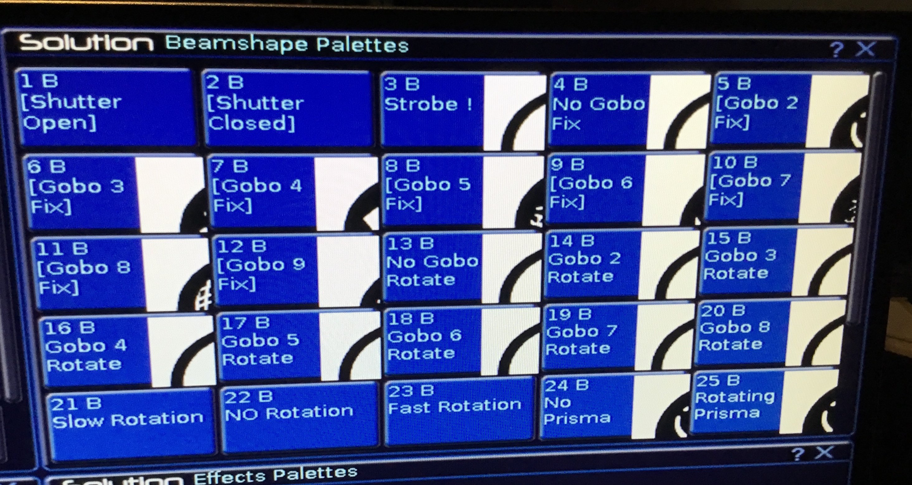

  4. The gobo pictures as not complete on the screen. I use Stairville MHX200 scans. How can I solve this so I see the complete gobo sign on the screen, do I need to update the scan data? any suggestions? Thank you
