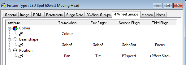

  10. How do you edit a fixtures Wheel groups so they will appear on the encoder wheels when say beamshape is selected on an FLX screen. I get strobe and reset as my first 2 rather than Gobo6 Gobo8? Thanks Paul
