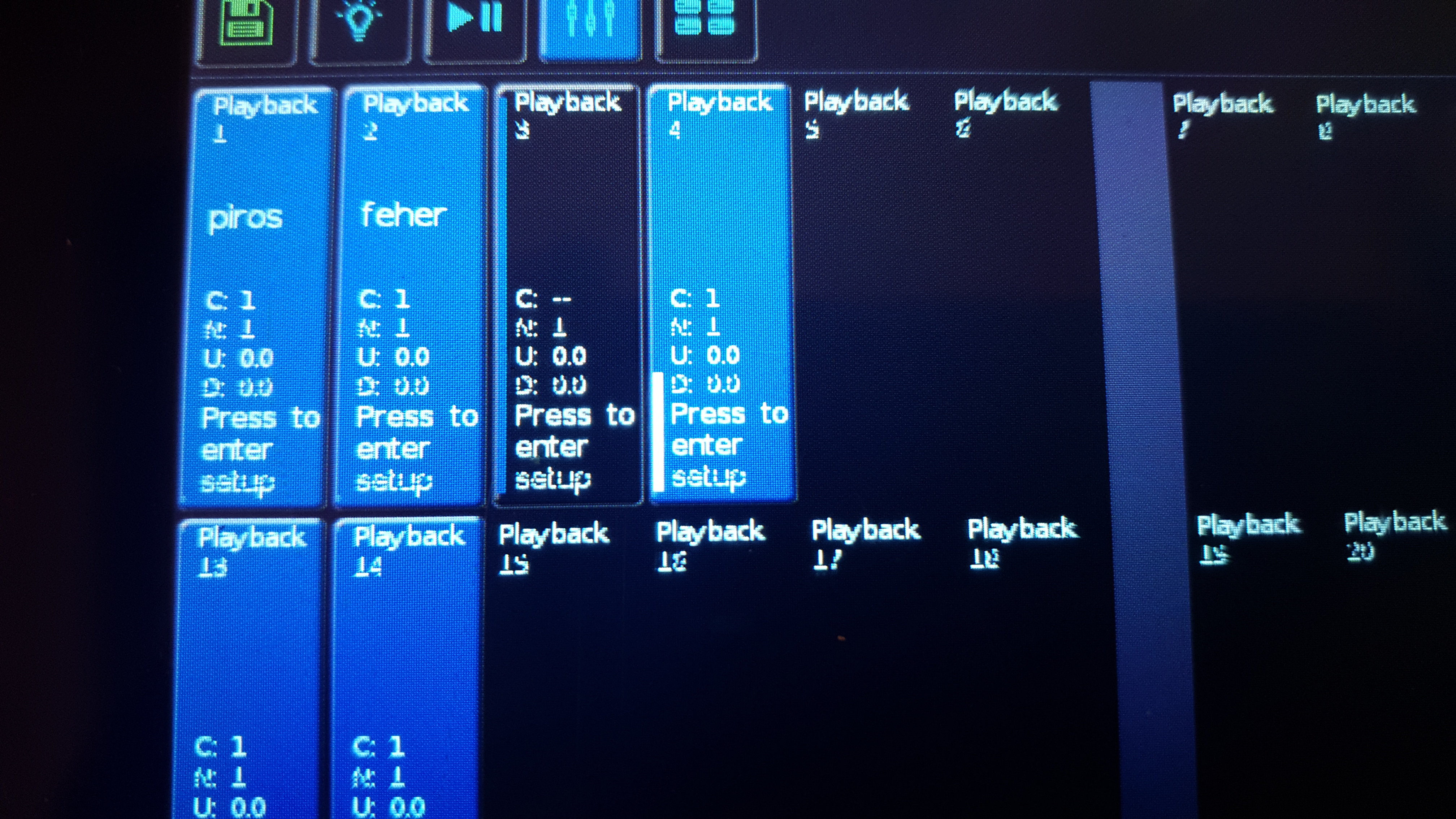

  22. Is this normal? My screen often looks like this. it looks it missing a lot of pixels, when I changing to another screen it looks ok sometimes not Daniel
