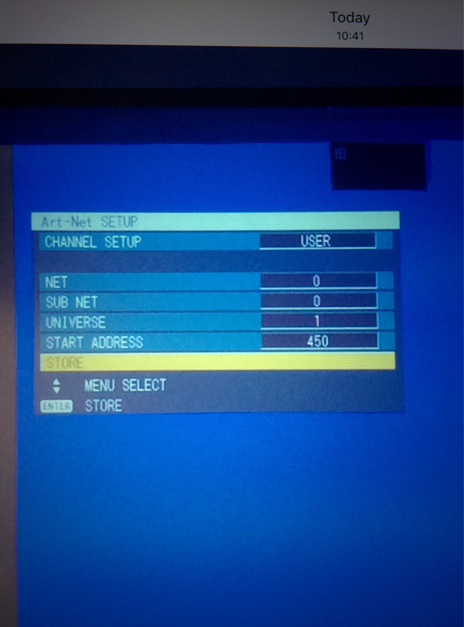

Just an update... I have it working, all stable now. but... the light output and shutter worked perfectly. The rest, so...so... not really what to be expected. For now I have disabled all the features on the projector and just left the fixture profile as is. More work needed I think. now I’m off to post about why I can’t get a laptop with unlock dongle to work as backup...

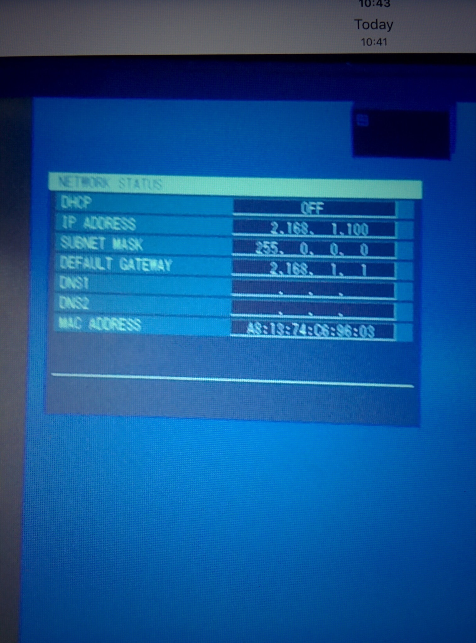

Ok... it just seems to have started working now... I ended up switching to universe 2 on projector and then patched to 3 on the desk now it will work however I switch between them. I can now see it in network devices. This came up before I had it working, briefly, but it went away... now it all seems to be working and I have no idea why... ha!

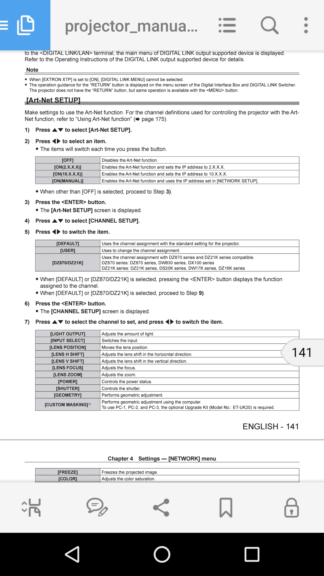

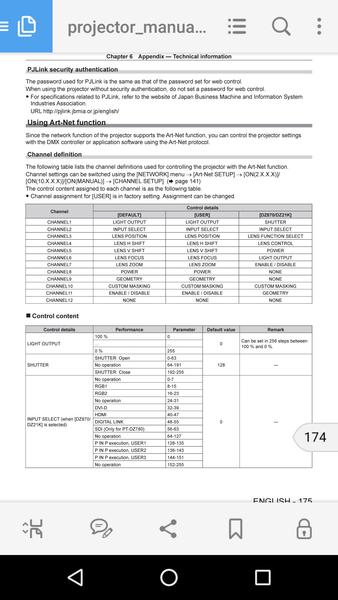

So... Trying to attach pics, but they are a bit big... using wirelesse router to be able see devices now - all devices seen as expected. 2.168.1.1 is router .2 is Laptop Wirless .3 is ArtNet DMX Node (working, controlling generics) .4 is FLX Console .100 is projector - in its network setup: dhcp is off is is 2.168.1.100 subnet mask is set to 255.0.0.0 default gateway to 2.168.1.1 arnet enabled as manual with channel setup user (with 12 set as shutter) net set as 0 sub net set as 0 universe set as 1 start address as 450 the fixture patch matches universe 1 with dmx address set at 450 i did realise this morning about the default on fixture profile for light output - so will change that at some point any thoughts?

Hi, I think this is the best place for this question...? Just bought a Panasonic Projector which is controllable via artnet - 12 channels of various attributes. Panasonic PT-DW750. But, having sorted a profile and also tried it the most simple way - I can not get any control of it. Has anyone else managed to get a projector working via artnet? Especially when there is no fixture profile already? Thinking I may need to post up projector network settings etc... Etc.. to help out? Thanks. Phil.
