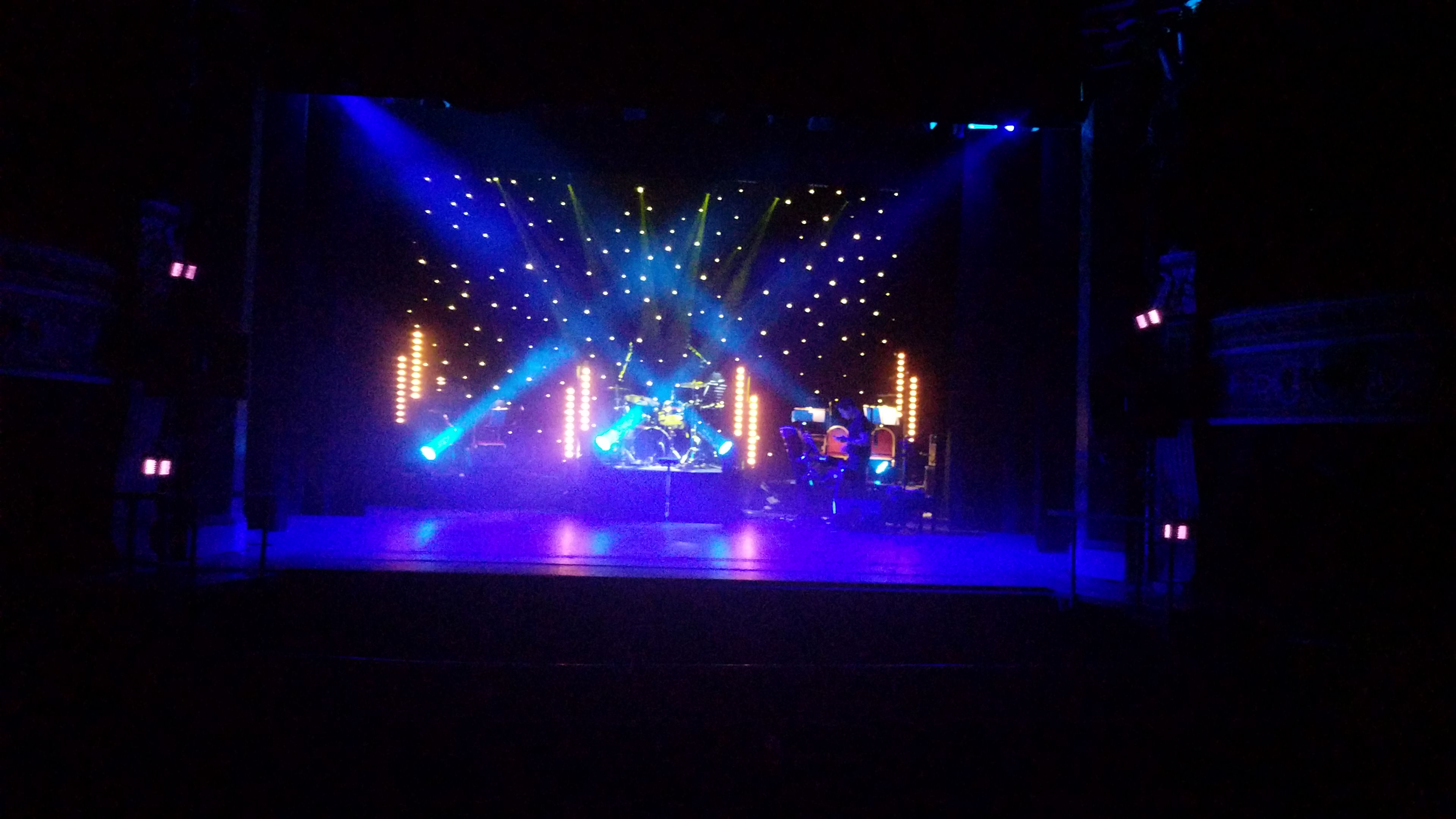

I have some SunStrips for an event, what's the quickest way to set up a random intensity effect for them?
