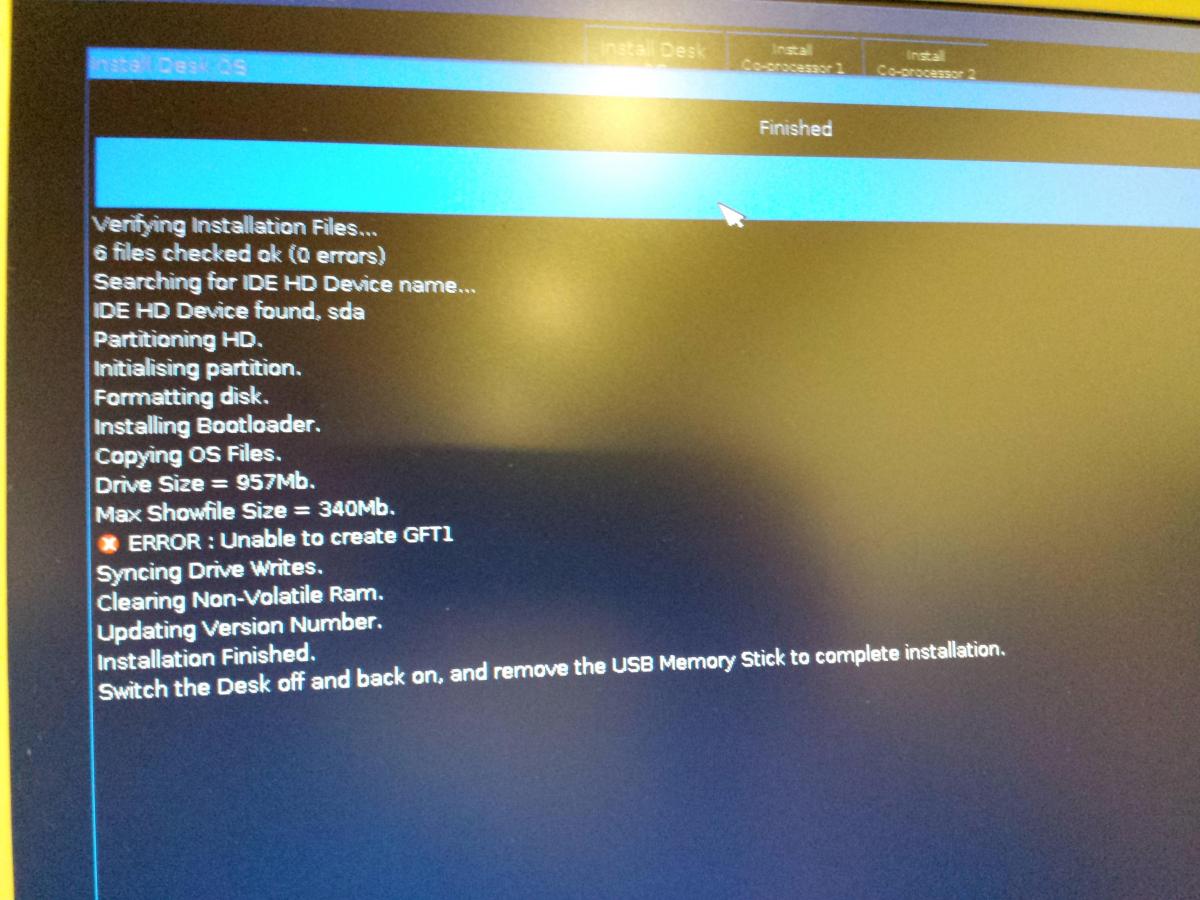

I tried installing the Beta Version which didn't work. On the external Display I could see that the image from the usb drive was loading after that I got the ZerOS screen with the loading bar and after that there was a black screen with a grey "x" in the middle.
After your release of version 7.8 I tried it again. This time the installation process went further which means that I got the installation windows where I could click to start the installation. The installation went on but I got an error "unable to create GFT1" in the process. I'm attaching an image of that error. I rebooted the LeapFrog 48 and now it always hangs with the black screen with a grey "x".
And now it's also impossible to reinstall the software again because I don't get the install screen where I can click to start the installation.
