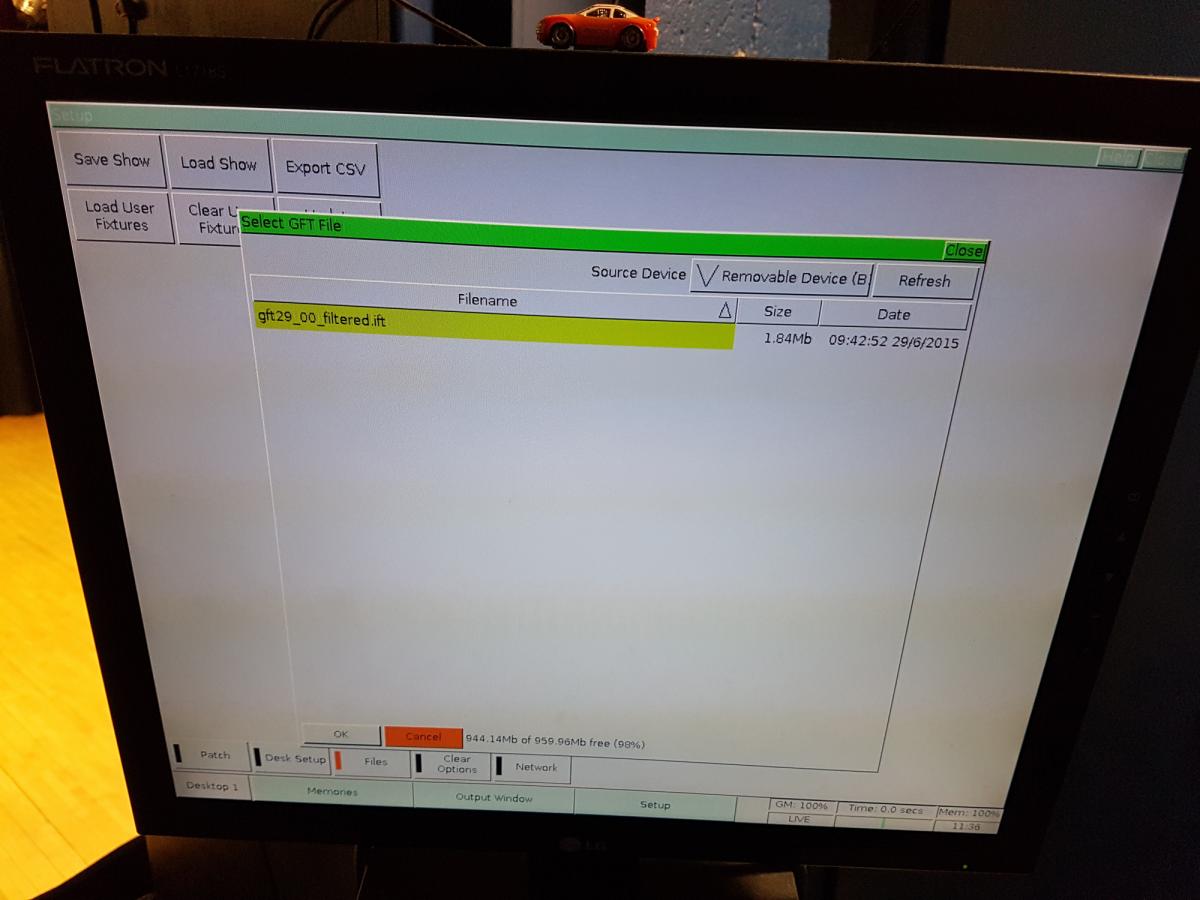

  1. Saved Files
    Hi My LeapFrog 48 has decided to stop reading the show files we have saved on the USB stick. It says in the load show dialogue box "select GFT file" and can only find one called "gft29_00_filtered.ift" When I plug the USB stick into my computer all the show files are on there. I tried updating the console to the most recent software and it was able to see the shows but when I tried running one of them it didn't make any of the lights turn on. I tried reinstalling the previous version of the OS, knowing the new version could see the show files, but it went straight back to the original problem of just showing the one gft named file. Any suggestions? We have exams coming up and I need it working. No idea why it suddenly stopped working. James
  2. Saved Files
    Short term solution One of the MFKs was sticking, so it was selecting update user fixtures whenever we entered setup mode. Long term we will need to look at the interface after the exams once we have updated to the new OS to try and work out how to make the current files work with the new OS...if anyone has any suggestions for that stage. Thanks for the suggestions
  3. Saved Files
    I'm clicking on 'Load Show' rather than 'Load User Fixtures' but this is what it's coming up with. It's also stuck in a loop when you click on ok or cancel and reopens the dialogue box pictured.
