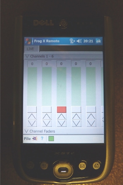

  9. Jon Sorry for the delay. We are upgrading the theatre heating during the summer break to try and increase efficiency and reduce gas bills leaving little time for anything else. Attached is a photo of the remote. After taking the photo I upgraded to v7.1. The remote is still the same. Norm
  10. Hi Using a Windows Mobile V5 remote with ZerOS V6 on a Leapfrog 96 worked fine. Since upgrading to V7 the display on the remote is now wider than the screen showing faders 1 to 5 and about a quarter of fader 6. What is causing this to happen?
