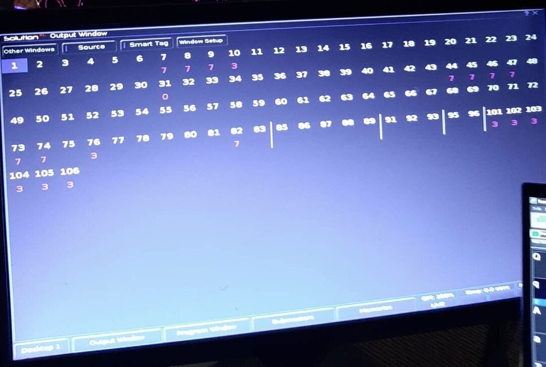

we have a problem with the zero 88 solution console, there are some output stays can not be cleared. Please refer to the attached picture. if you zero the grand master, the output will also be zero. i do not know where are those output come from. Advice will be appreciated. Charlie
i pull the console apart and found there is one cable did not plug in properly, after that seems better.

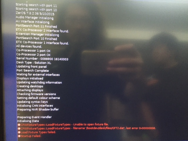

It is a new Solution XL, i opened the packing box and worked with it for 3 days and crashed twice. I have to reinstall the os to get it recovered. The first day worked fine, and next morning it failed to boot up get the message as the attachment. i reinstall the system. On the third day which is this afternoon, when i moved from one office to the other, when i turn it on, it happened again. What might be the problem, i did not do any programing on the console yet. Just try to link with the remote iPad. There is no shut down procedure for turning off this console, just switch off if i am right?
